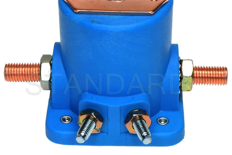

It took some doing to get on account of NAPA's difficulty in getting S.O. parts from outside resources and a delay at the NAPA local warehouse but I finally got a Standard starter solenoid. (As in Standard Motor Products and the Blue Streak line of old)

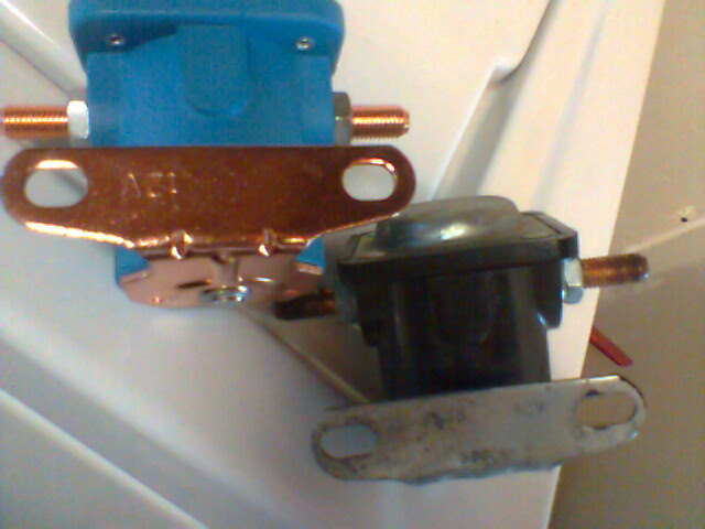

Upon removing the Echlin solenoid I immediatly saw what was going on.
The contact case seems to be made of aluminum and it was oxidized, and it was bolted to the painted inner fender skirt. What this means is the ground was only via the small bolts holding the thing on
No wonder it failed.
So I took my wire brush attachment to my drill (after moving the wiring out of the way) and had at the patch where the solenoid makes contact. I then applied some dielectric grease to stave off oxidation for the time being.
Opening the package for the SMP solenoid I was dismayed to see they are now being made in China. This, despite my online reseach pointing to manufacture in Ohio, as I recall. Nevertheless this solenoids' contact was solid copper lending to continity for this circuit way better than it's predessor.
