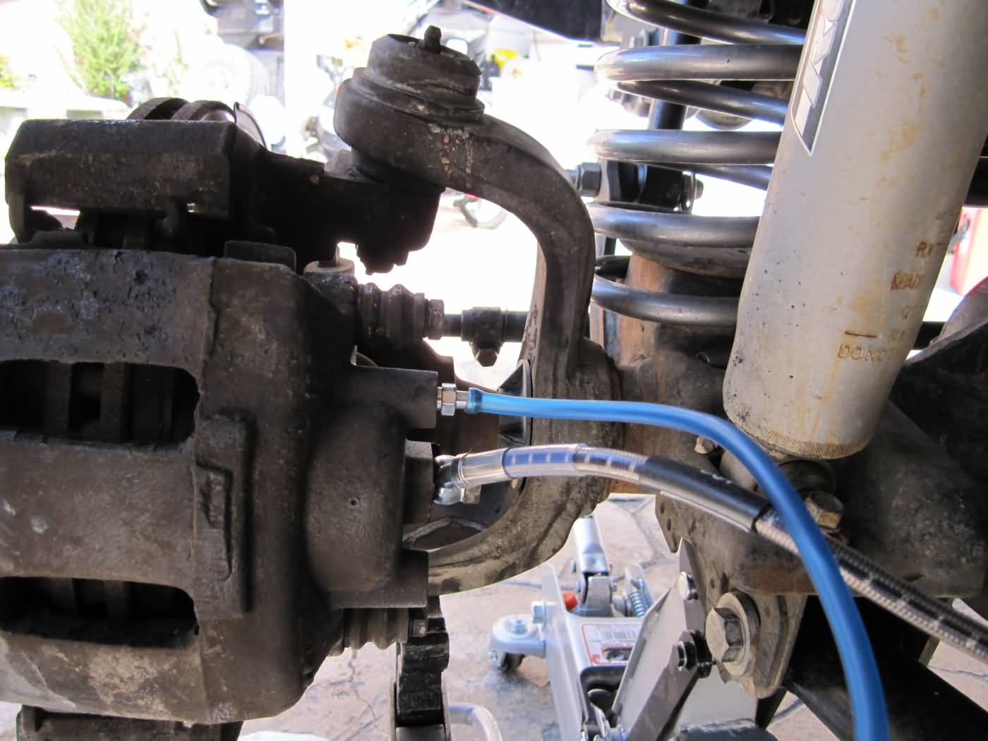

Stock flexible brake lines

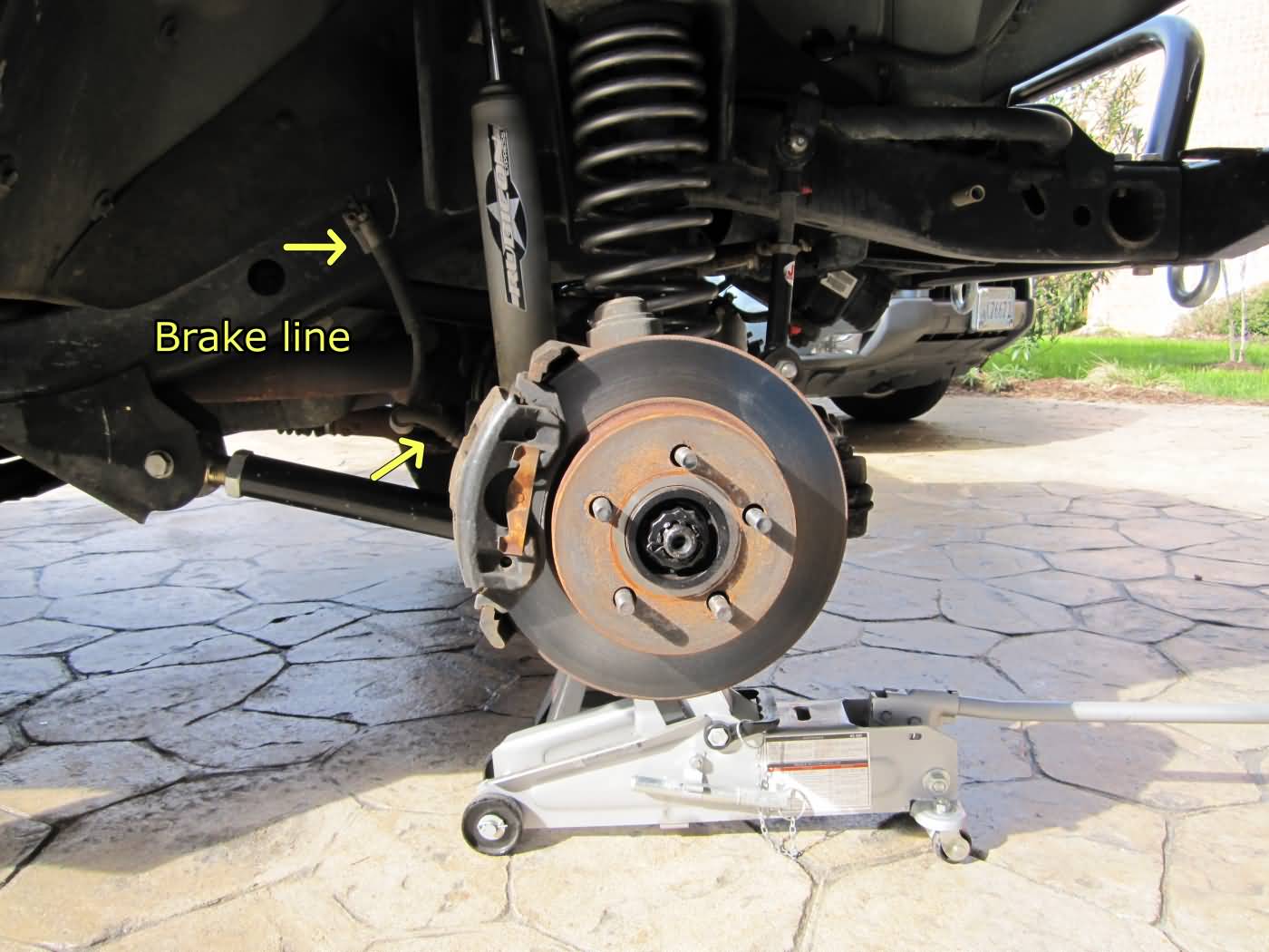

Here are some photos of the stock brake lines.

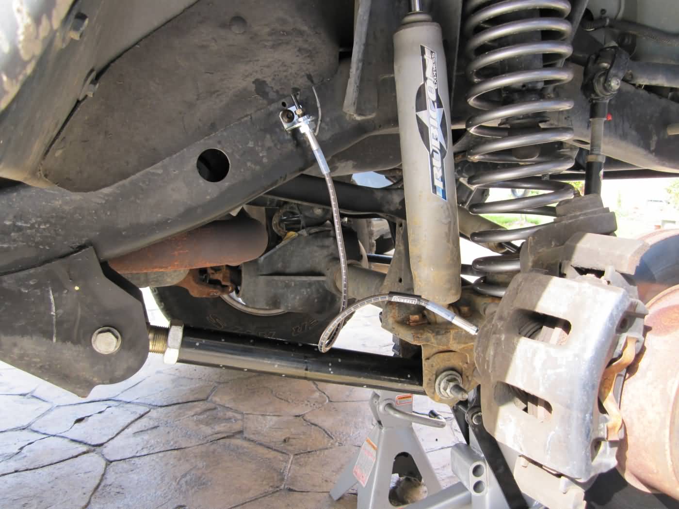

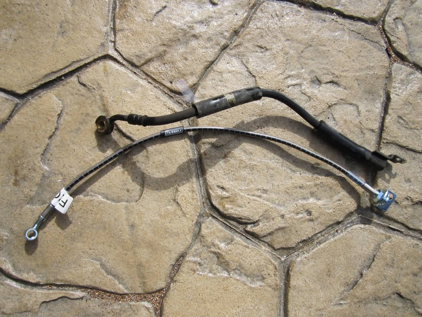

And here are the new longer brake lines that I purchased from Quadratec
This is a side by side comparison - you can see how much longer the new line is.

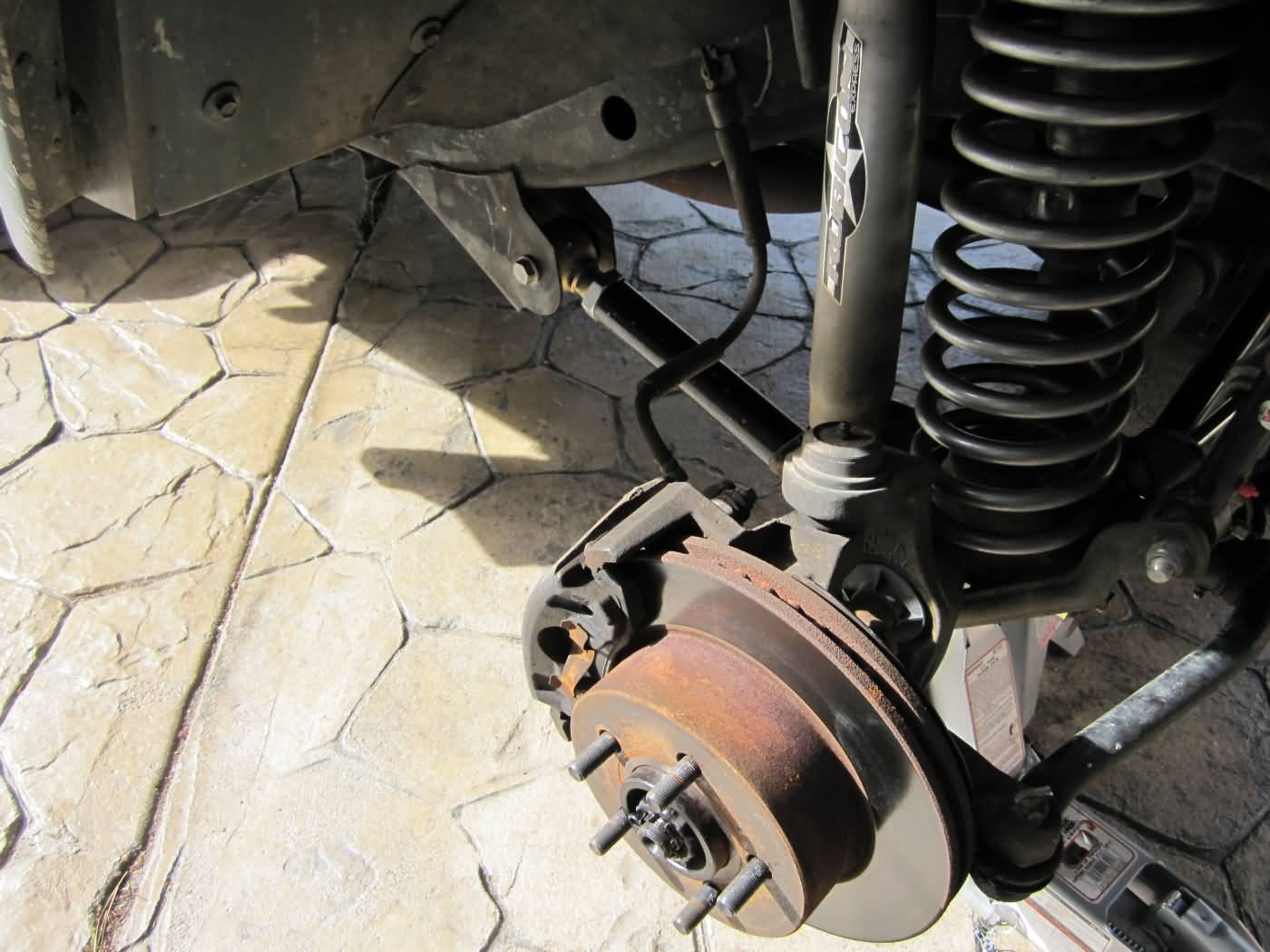

Step 1 - remove stock brake lines.

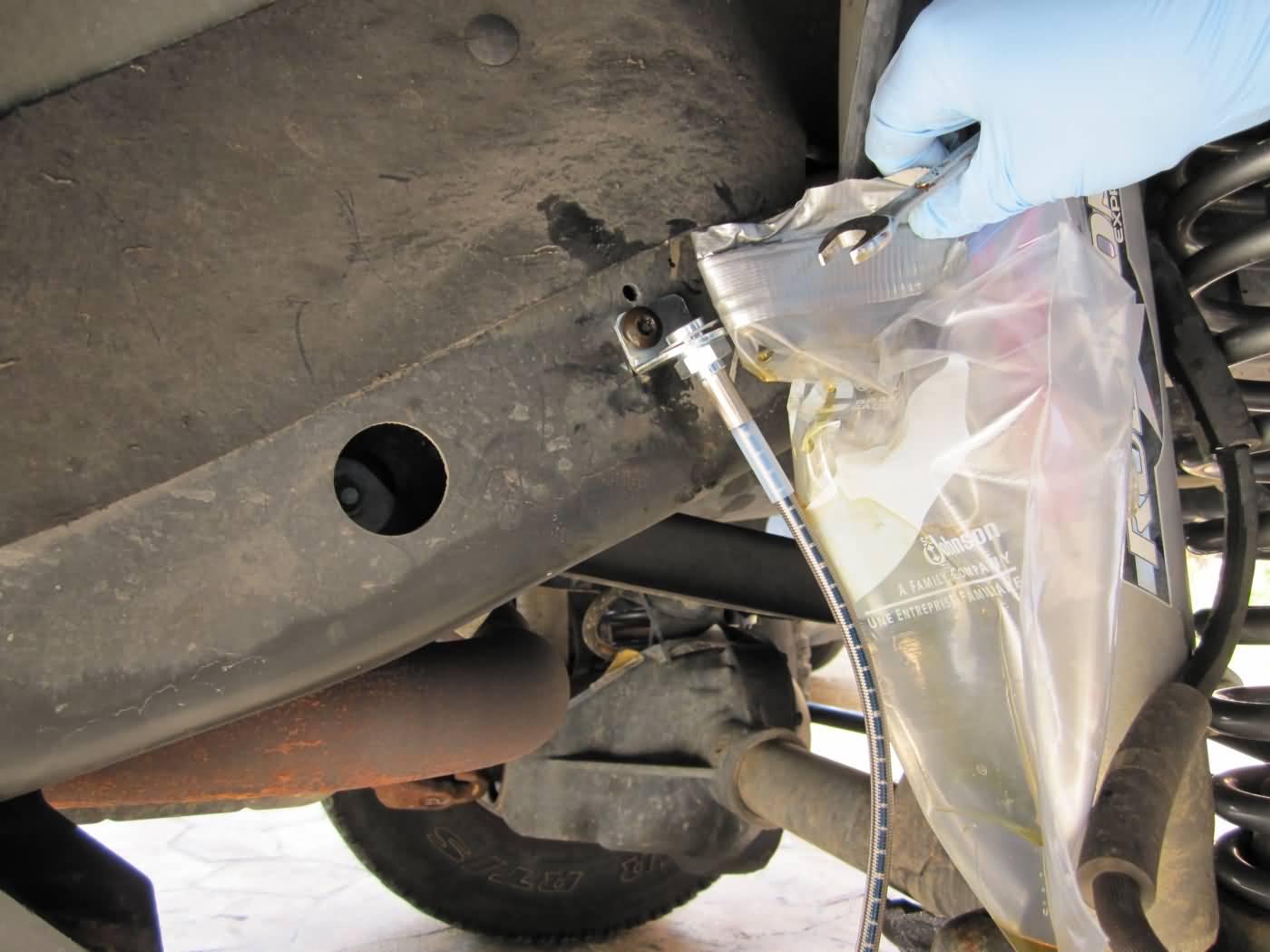

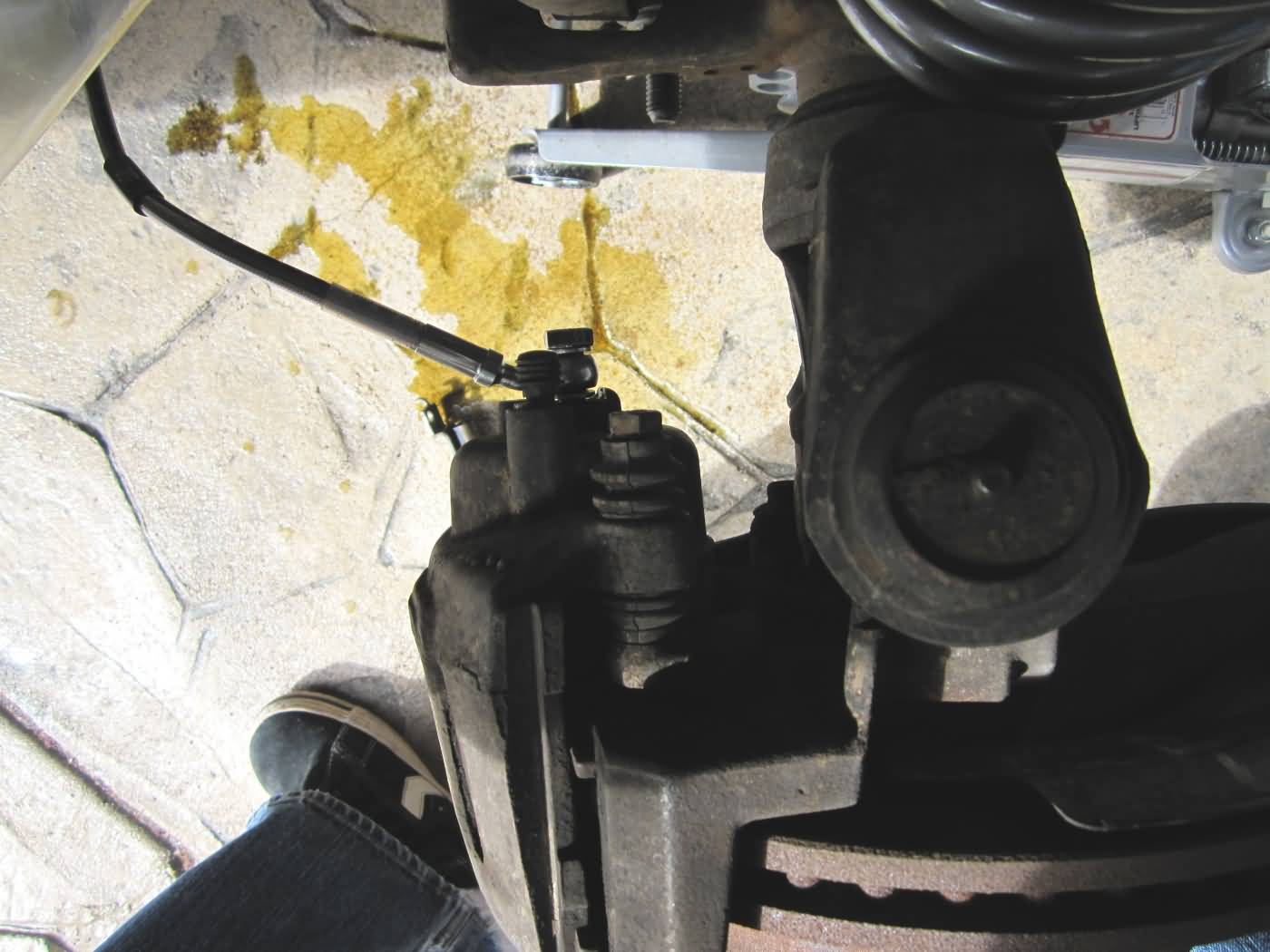

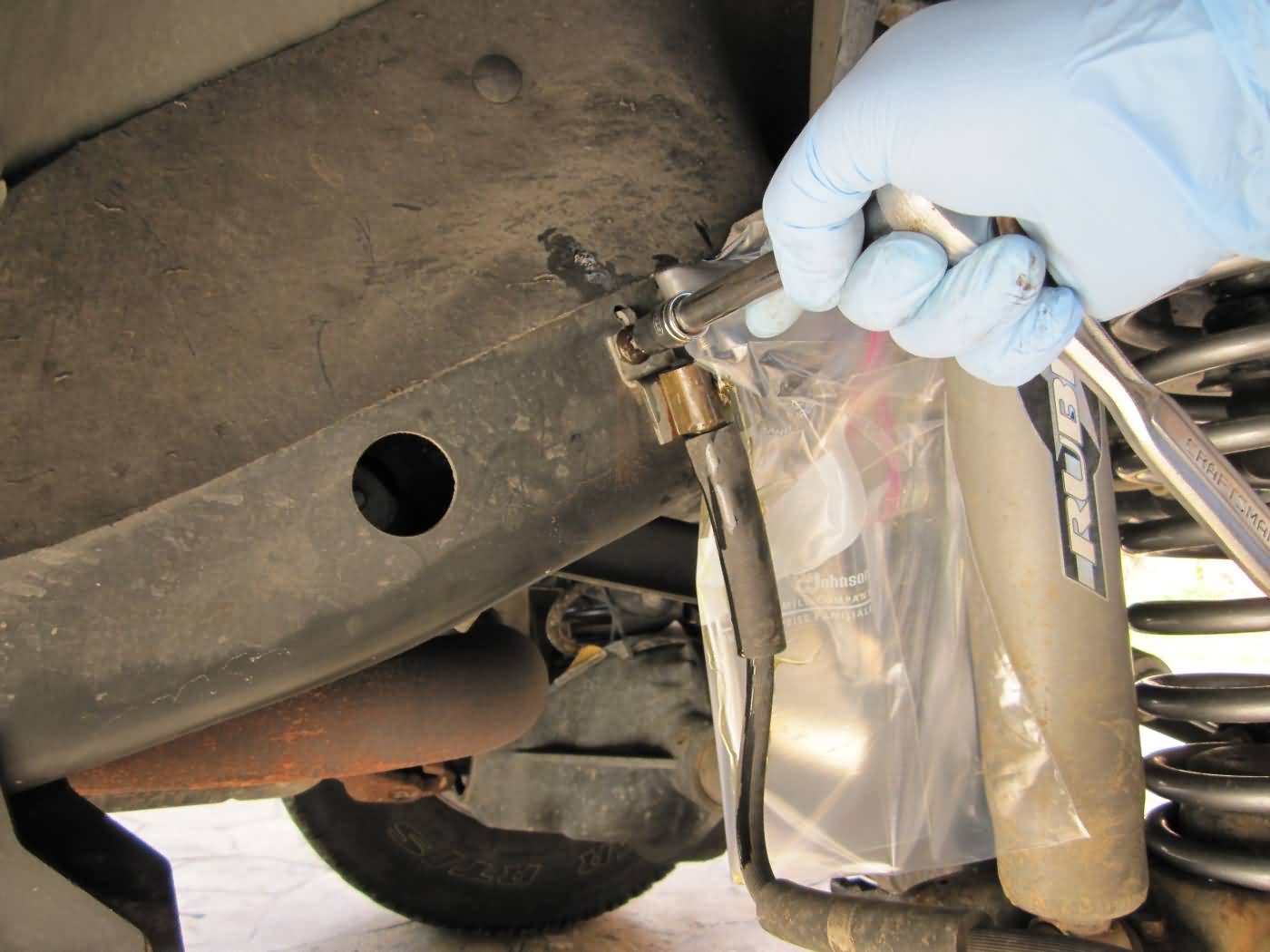

You'll need to remove the stock brake lines first. This requires you first disconnect the hard line from your flexible line (a wrench is all it takes).
Once you disconnect the hard line, fluid will dribble out of the line. I taped a Ziploc bag to the line, so that the fluid wouldn't pour over the area I was working in.

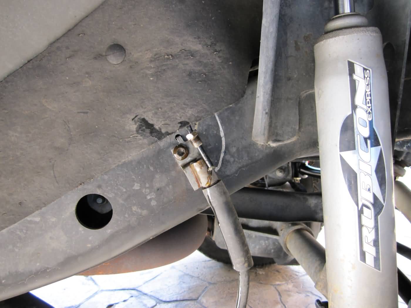

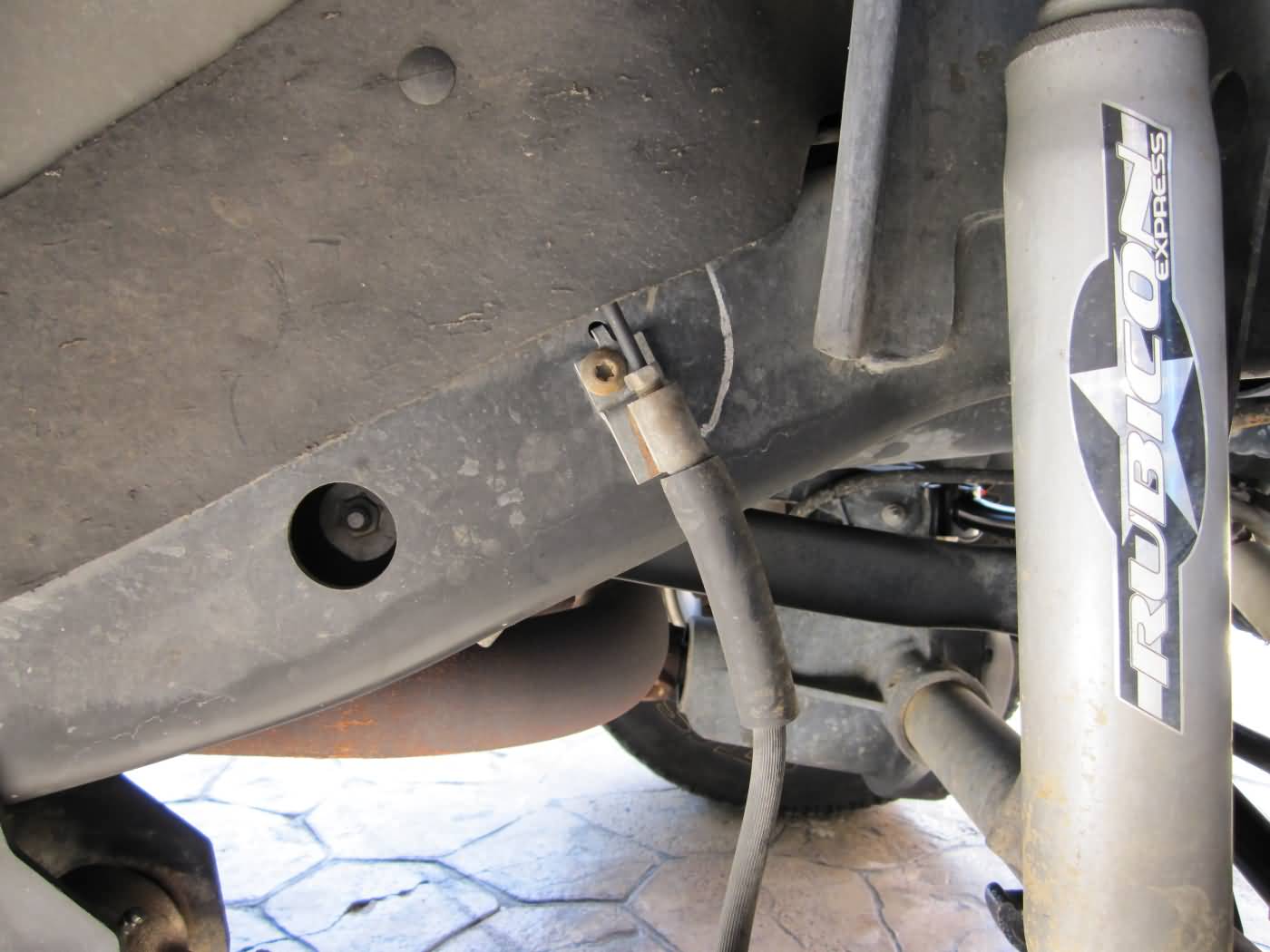

Once the hard line is off, you can remove the torx bolt that holds the flexible brake line to your Jeep

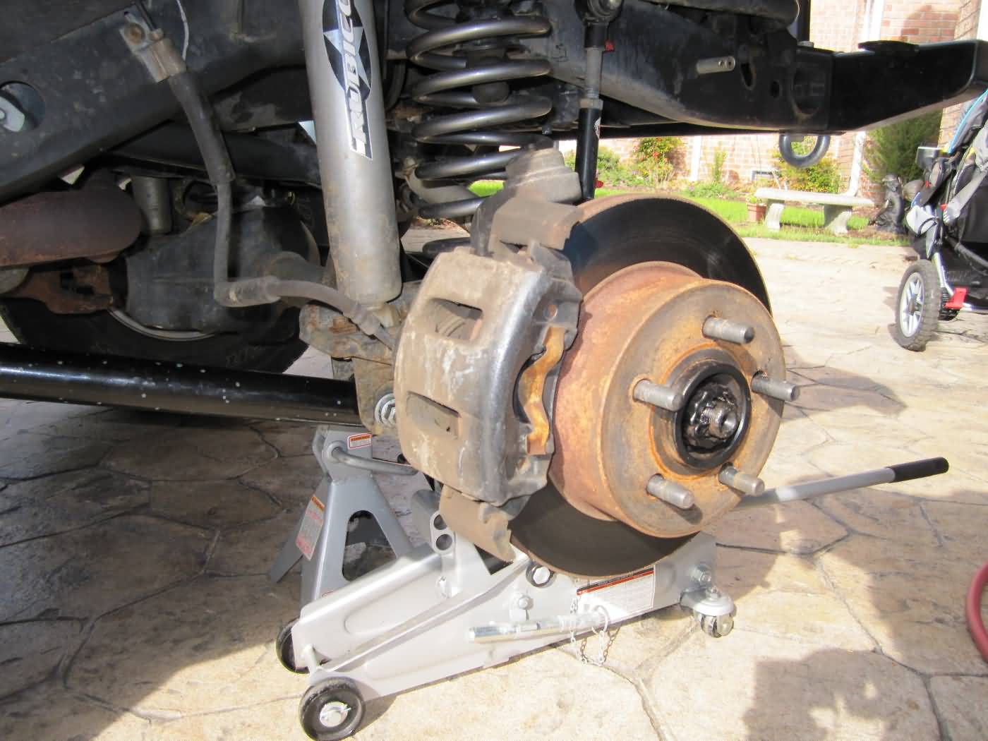

Now, using a socket wrench, you can remove the bolt that hold the bottom end of the stock line in place

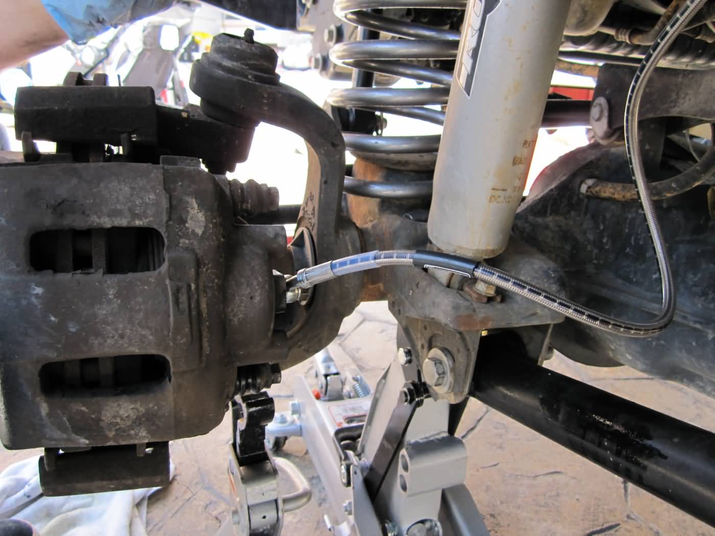

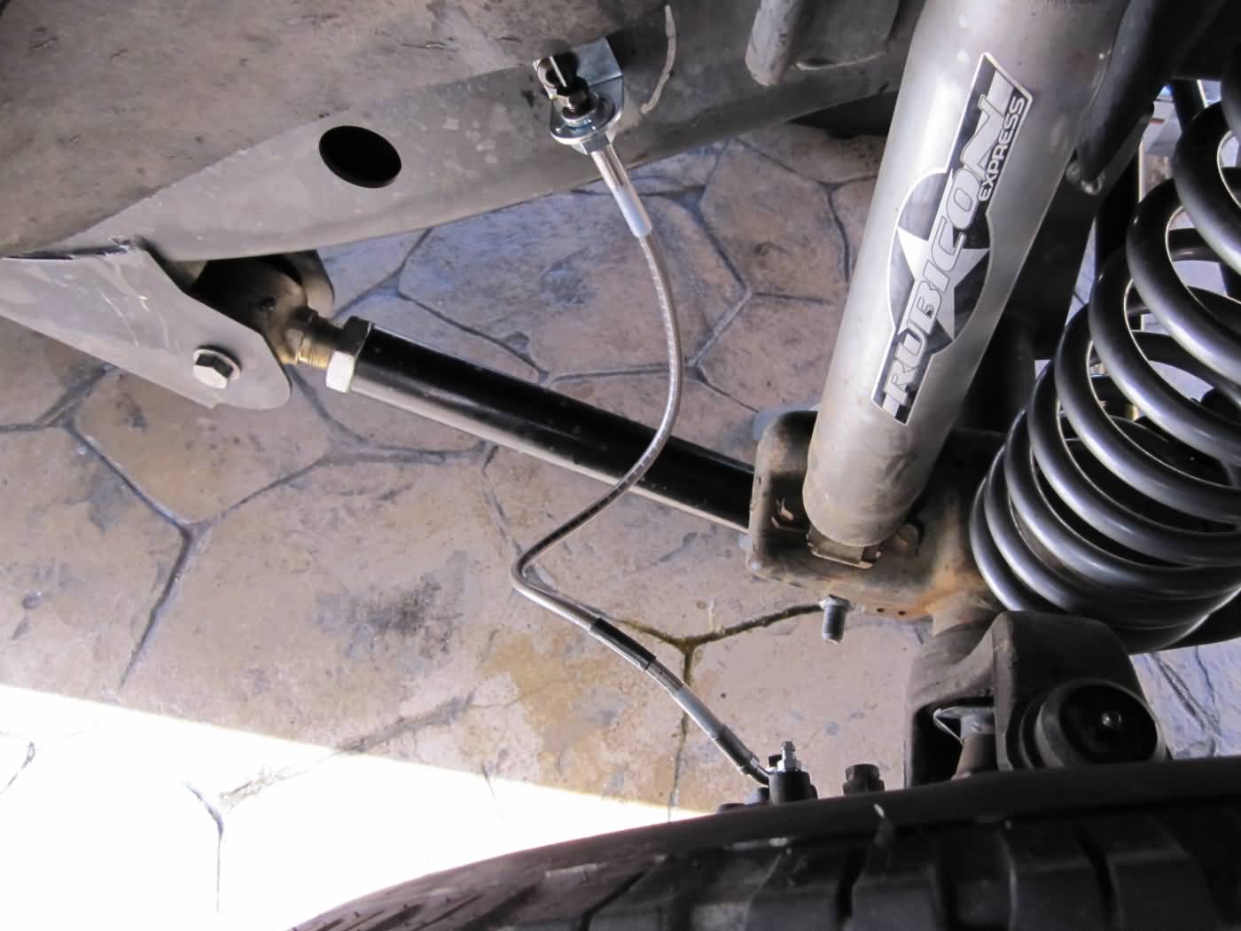

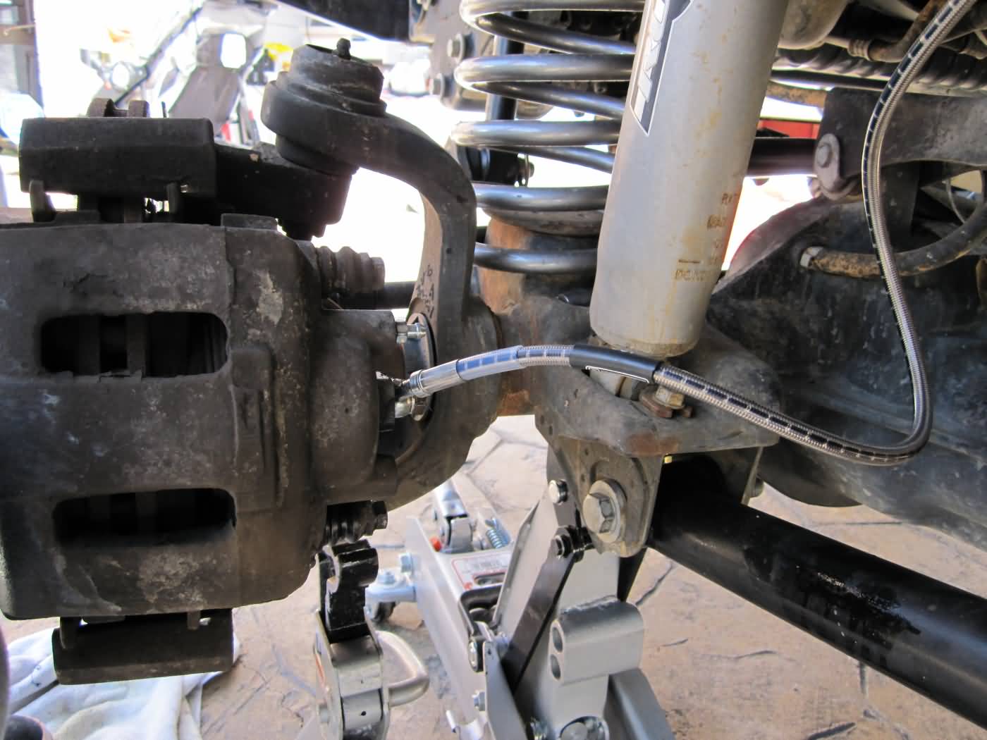

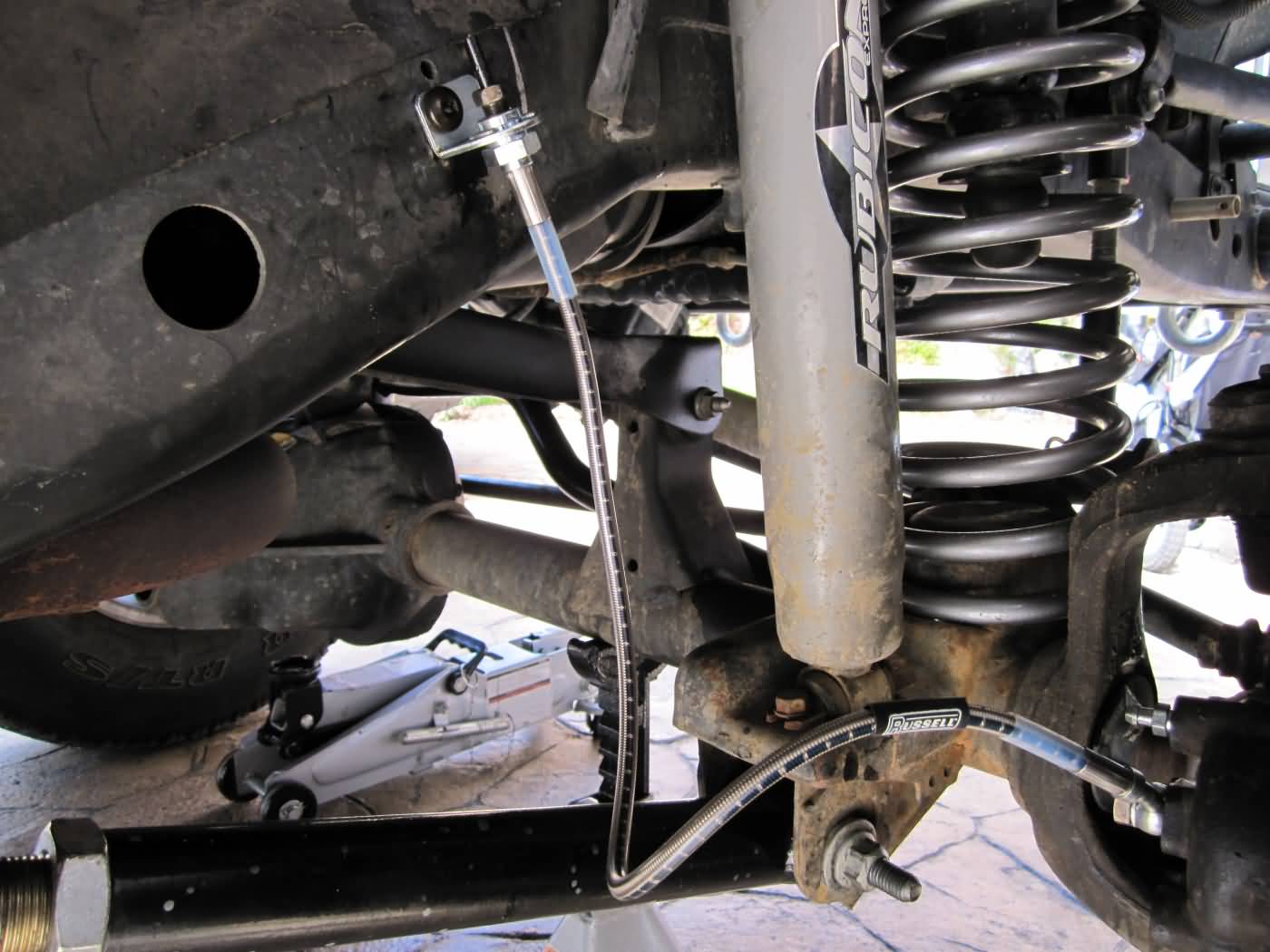

Installing the new flexible Jeep lines is really just the opposite of removing the old ones. It bolts up in the same manner
This is a shot of the brake line, where it bolts to the caliper
And the new line in place:

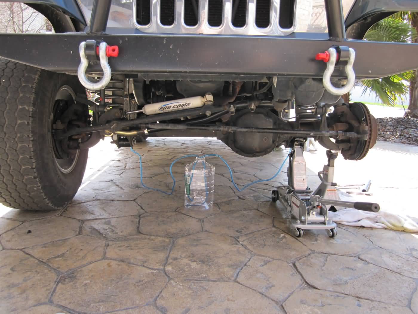

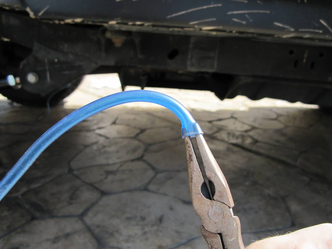

You could just let fluid squirt all over the ground, but I'm not really into that. I used aquarium tubing that I stretched then slid overtop the bleeder, and fed into a container to catch the fluid. This also has the added benefit of allowing me to get out of the Jeep and inspect how much air is coming out. I just kept pumping the brakes until there was no more air in the tubing
Flaring the end of my aquarium tubing
Then press that end onto the speed bleeder
Running the tubing back to a collection jug
