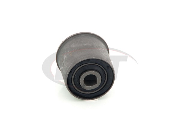

You can drive but put it on the to do list - look for polly bushings a firmer feel to them
I'm not a fan of poly. While you are correct they are firmer they also squeak and can be too firm when they need to absorb.
Others like this Moog has two layers of different rubber and thinner amount of rubber. The delta is steel
