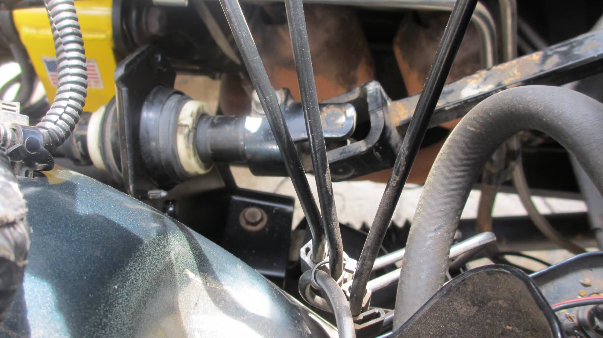

Here's the angle on the stock bracket

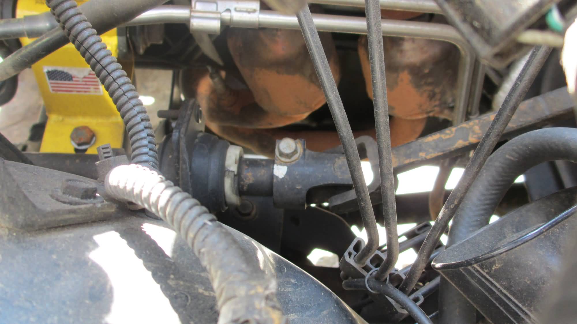

And the angle of the new bracket:

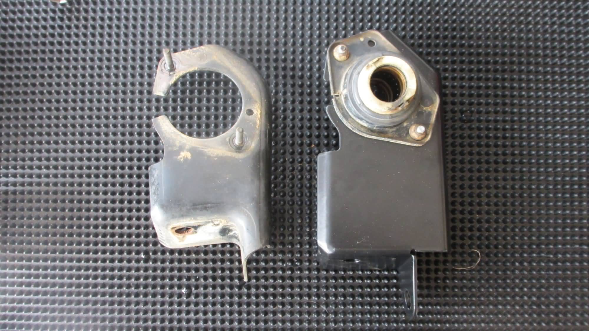

The stock bracket versus the 1" lift bracket:
