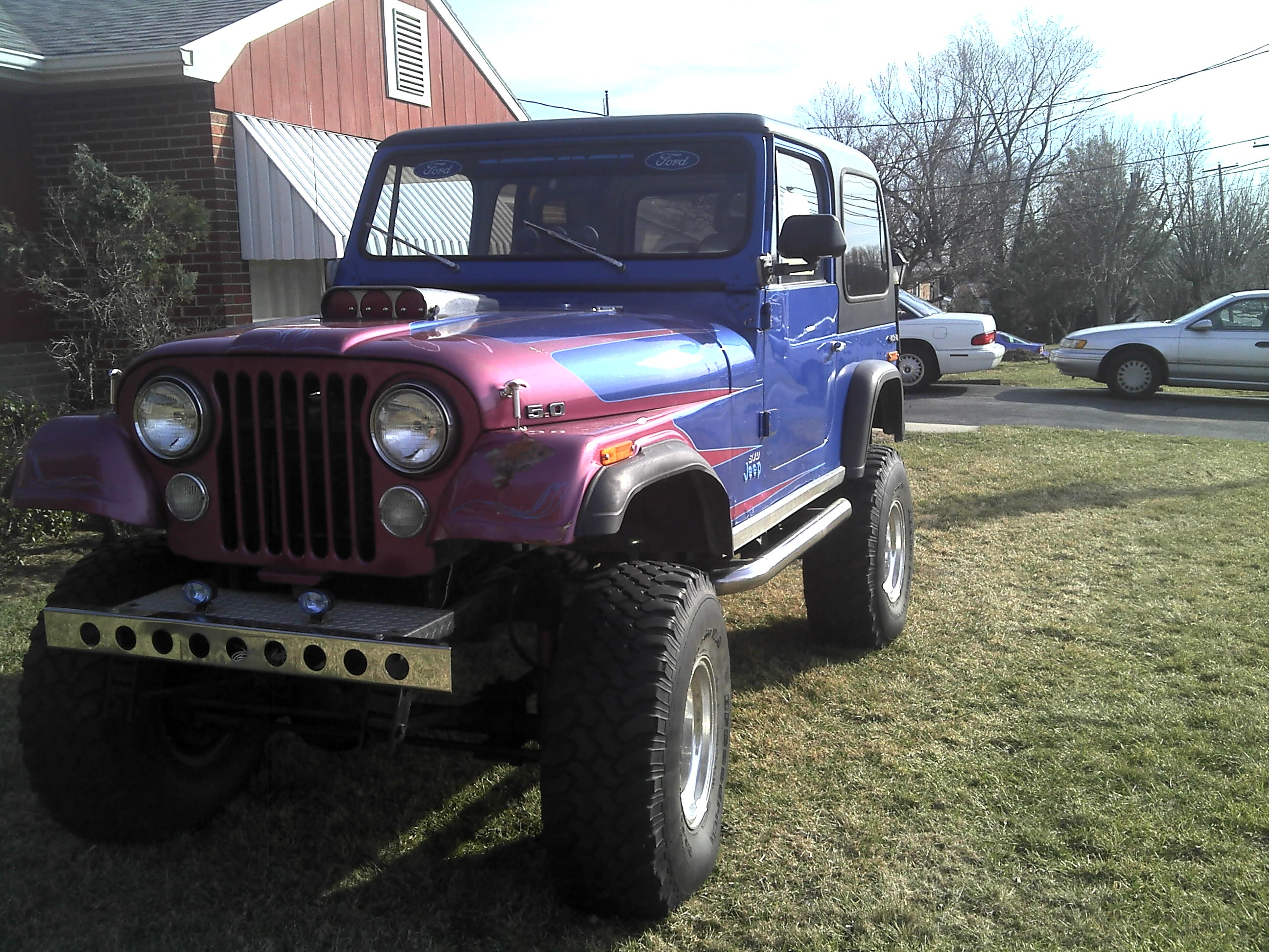

i have a 302 in mine and i love it
I prefer a 302 to a 350 because the power feels the same to me for a stock vs stock set up
