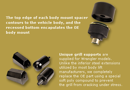

I'm going to install a 1" body lift, and will probably replace my body mounts. It appears that most aftermarket body mounts are made of poly, but I've heard that this doesn't absorb the shock that a rubber mount will.
What are your opinions of poly mounts?

I just ordered the JKS body lift and JKS riser motor mounts from 4WD for my project. I'll post a trip report once I get everything installed.
