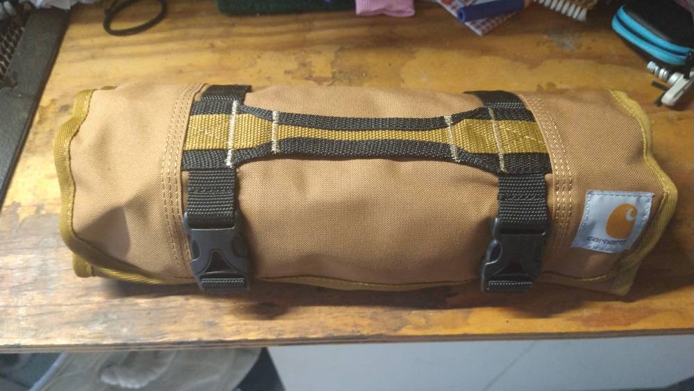

Great ideas. I hadn't thought of it, but the old roll up was a vinyl / plastic combo that likely stored moisture. I poked around on amazon and ended up buying the below. I'll coat the tools with a bit of WD40 and give this a try.
Amazon.com
cacheJeepzImage.php

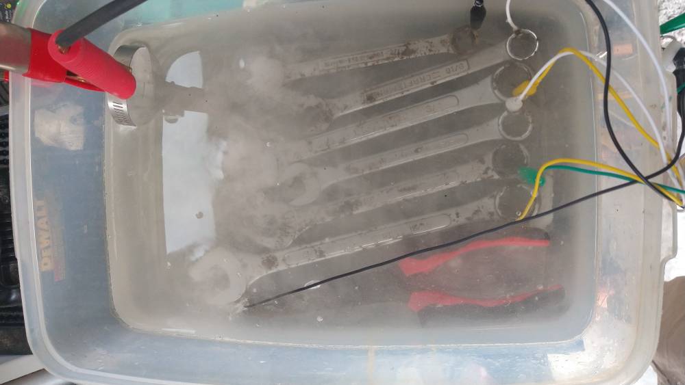

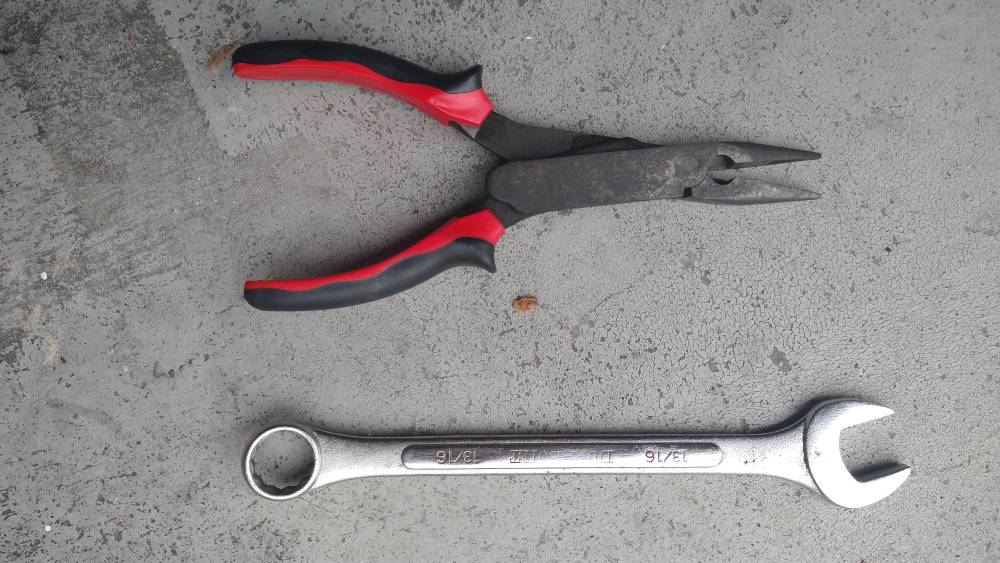

Before putting my tools in their new case I wanted to clean off the rust that had accumulated. I ended up trying electrolysis, which is really just attaching a battery charger negative to your tools and positive to some sacrificial steel. It worked out much better than I expected.
