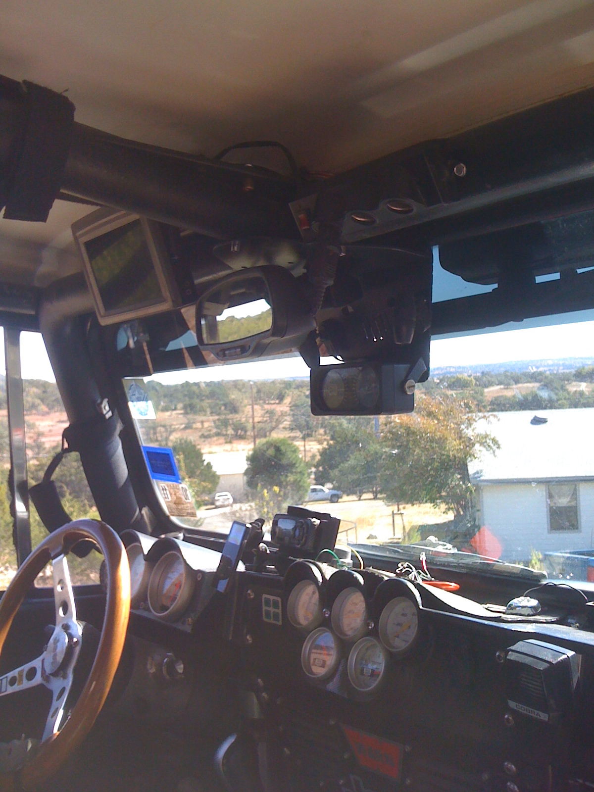

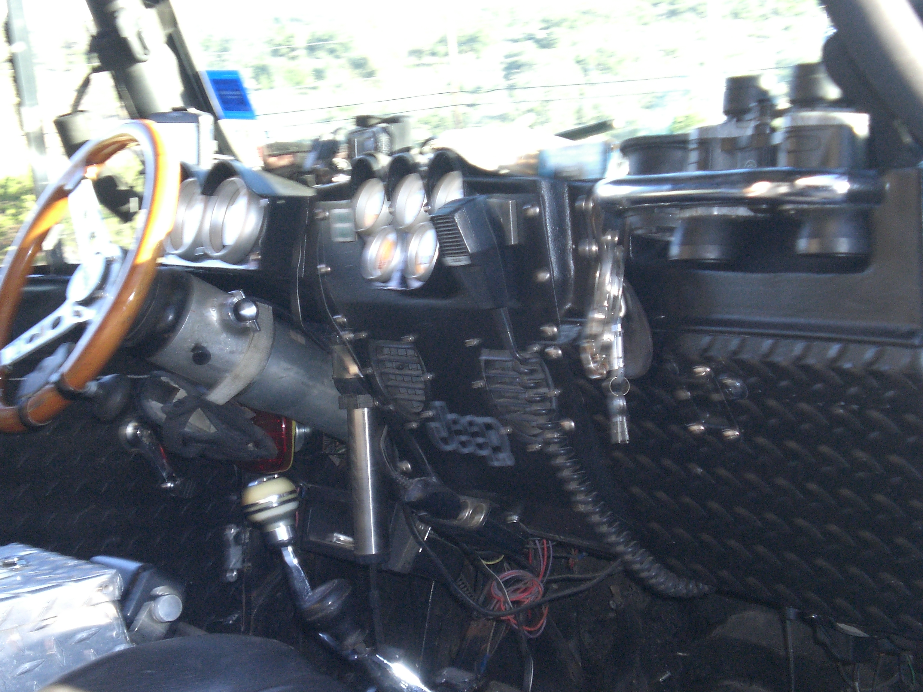

Here's what i built for mine.
Sorry, no. I hand rolled all the sheet metal with an English wheel the did the cuts with a die grinder cutting wheel. I built the entire dash.
