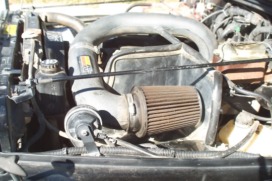

Be careful of what other mods you do. I put a FIPK air system on the Mighty YJ. My big plan was to put a 1" body lift on it to get 35" tires on it when my current tire wear out. Unfortunately, the FIPK uses a cold air box. In order to do a 1" body lift, I will also have to space up the cold air box and install a throttle body spacer now.
