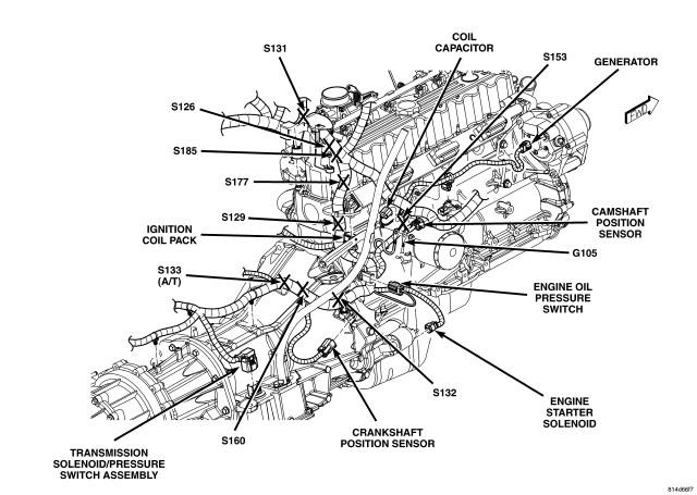

Note the pressure relay marked. Check the wiring.
O2 sensors don't usually go bad for the same reason without some other common cause. Like an exhaust leak above the top O2s like in the manifold at the engine. Bad PCM or bad connections.
