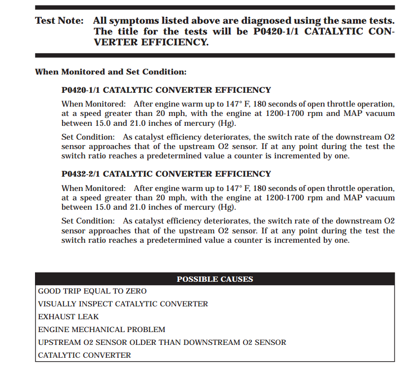

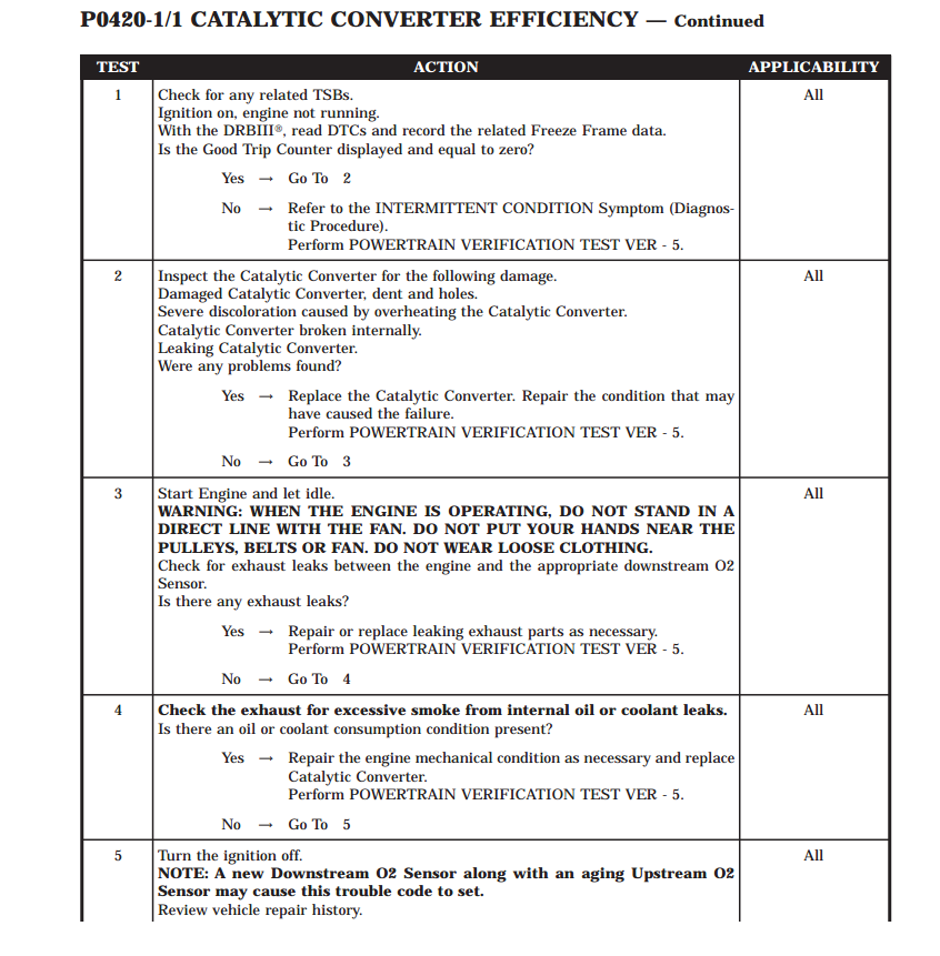

I think mark may be on the money here. Let us know which O2 code your getting.
I believe that you have 4 O2 sensors, 2 upstream and 2 downstream. The downstream sensors are responsible for monitoring the health of your cat.
