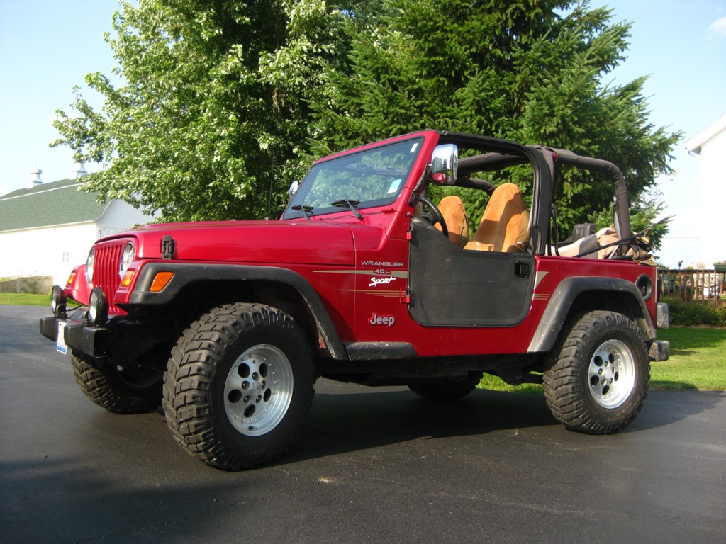

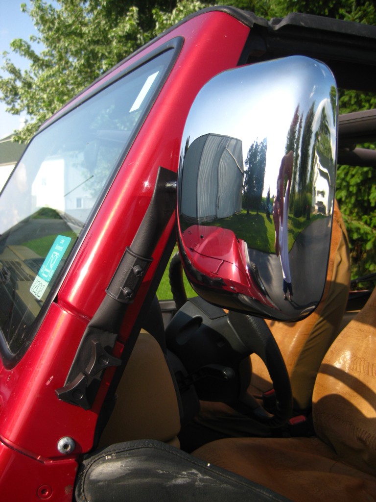

I finally came up with an inexpensive solution for mirrors when I take off my full doors.I made up my own brackets out of 3/4" steel conduit, flattened the ends, put a connector in the middle for angle adjustments, painted them with truck bed coating, installed some mirrors from Auto Zone and fastened them where the two windshield hinge screws are. I picked up some 5/16 X 1 1/2" (could have been 1" long) clamping bolts with the three sided plastic knob. With those, it's a pretty quick install/removal. There's a little vibration, but they're fine and only cost about $20.00
