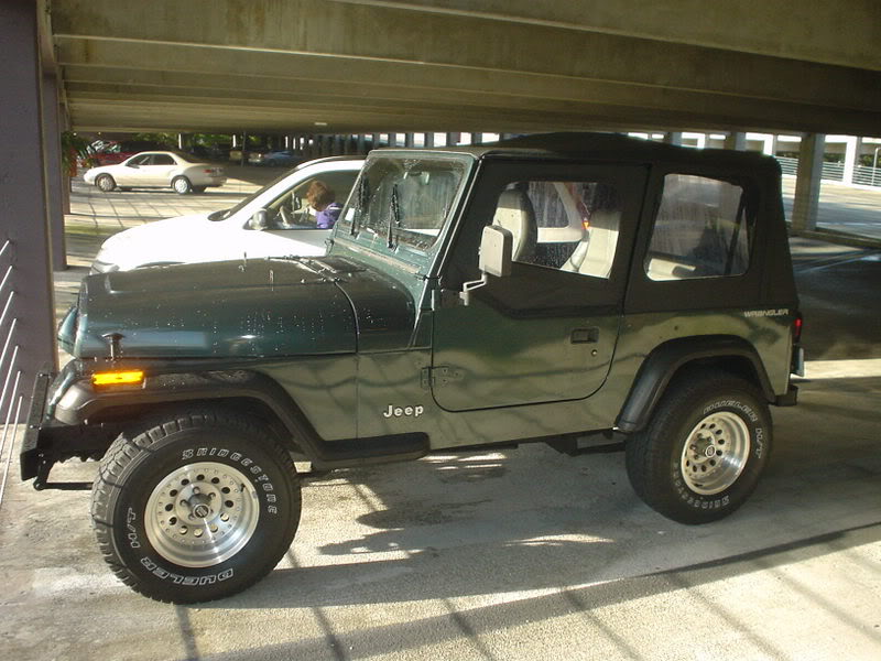

I first did the 4" lift (kept the 31's that came with the Jeep). I installed my SYE at the same time I did my lift. Now, thanks to the rear pinion angle, I had REALLY bad vibrations, and had to correct this so the CV shaft would work as it should. Here's how the Jeep looked at the time:
I then went to 4.88 gears but still kept the 31's. Let me tell you, based on my experience (and assuming you have a manual as well), I would forget about 4.56 and go straight to 4.88... I then bought the new 33's, and started wishing I could go to 5.13! Here's how it looked 2 years ago:

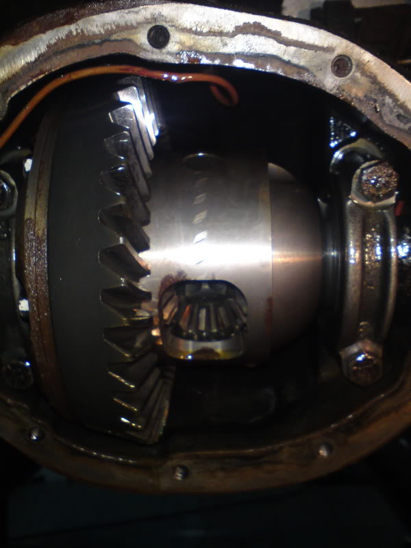

And just for the heck of it, here's how the D35 looks today from the inside (ignore the marks on the ARB; that's from a previous issue that has since been fixed):
I also agree that it is better to throw a Ford 8.8 in there rather than throwing money on a D35, but then again, I threw my money on the D35 and it has yet to fail me (although I do know it is my weak link, especially with 33's and ARB's; I DO have, on the other hand 31 spline alloy axles in there).
