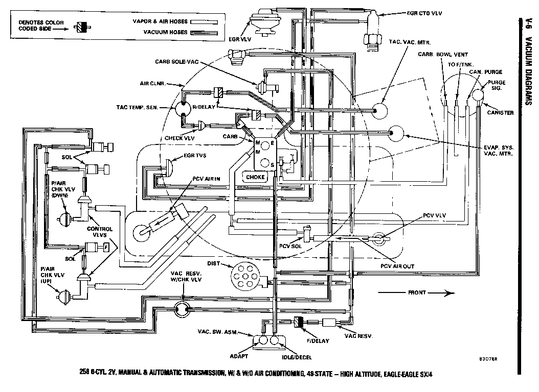

I am trying to up load a picture with this post the way the forum has it on this site if that doesnt work then photobucket works
you can post pictures with the post , I didnt have any problems
