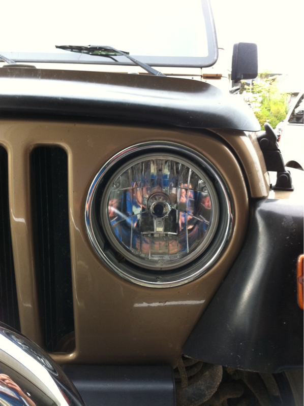

Just swapped out the old school sealed lights with a new style set from rampage, very easy swap, just need to wait till dark to see how much of difference they make.
Some before and after pics would have been cool. Post "after" pics anyway, if you can. Let us know how the new lights compare to the stockers on a scale of 1 to 10 with 1 being no noticeable change and 10 being double the illumination (of course, in your opinion).

I swapped my stock sealed units with the H4 conversion by Hella, put in some PIAA, and on a scale from 1-10...they were better by an 11
Here's a quick shot for now, they look a lot like the ones in the JK.

I agree with Midnight, those fluted lenses of the Hellas are just great, go figure those Germans and their technical prowess of optics has been world class since before WWII.

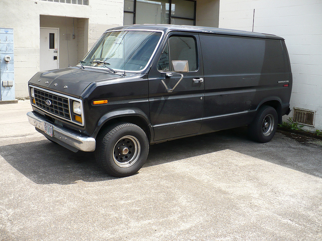

I run Hellas on my van too "Easy Bake"
and when I upgraded the entire lighting circuit in the van the difference was incredible. As I recall stock wiring was 18 gauge so I went with 10 gauge from the power source, through one 60 amp relay for each side and new sockets for the H4 bulbs, 190/110 Properly Aimed so's not to blind oncoming traffic. Before this, I was considering adding auxilliary lighting but the amount of light this conversion puts on the road is viewable from the ISS. I went with the Hella shells on my Jeep, but kept the wattage down as it seems high output H4 bulbs are traditionally fragile in respect to the filaments. Using Wagner H4's 190/110 I go through a bulb about every 18-24 months in "Easy Bake".
