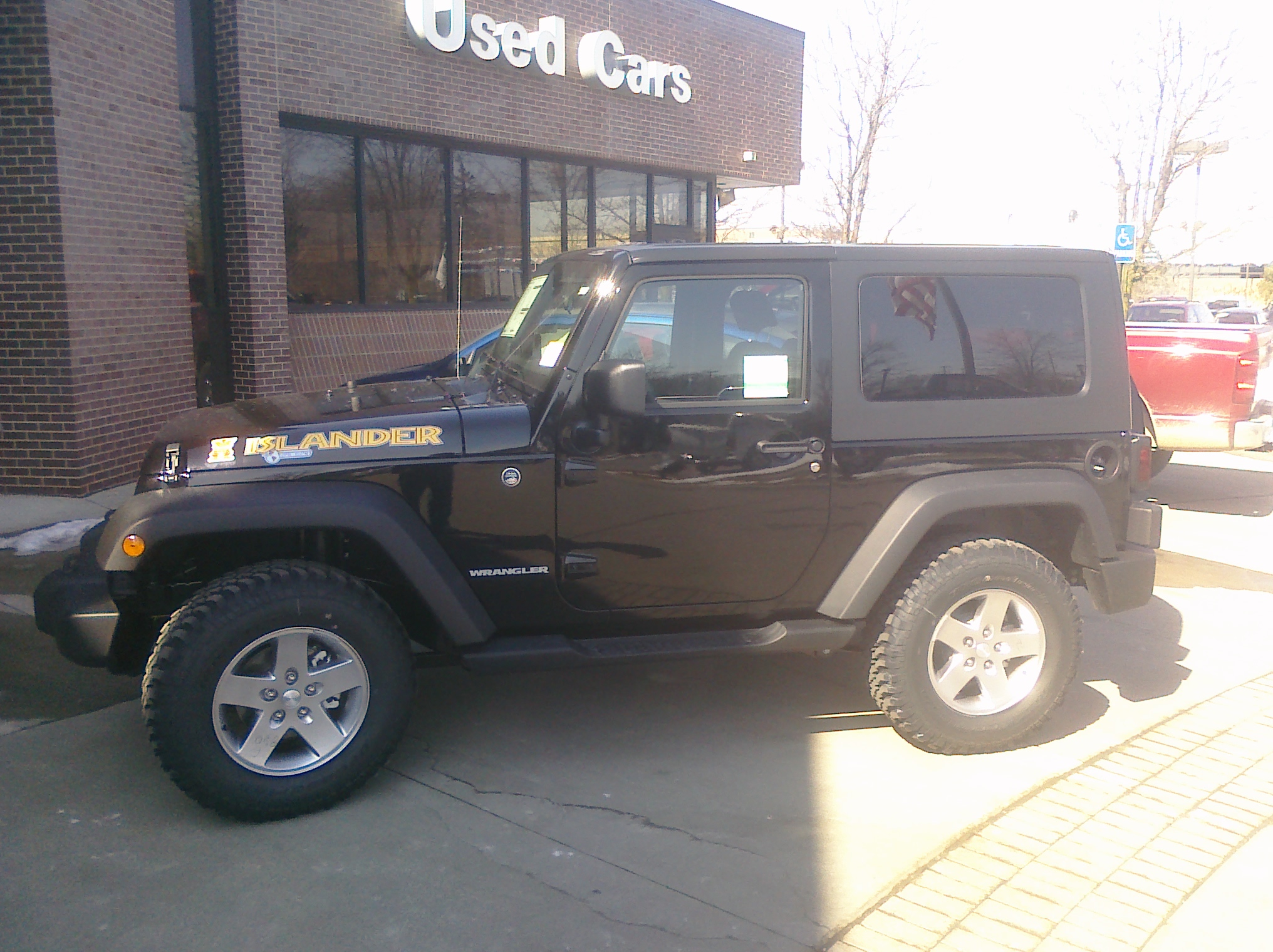

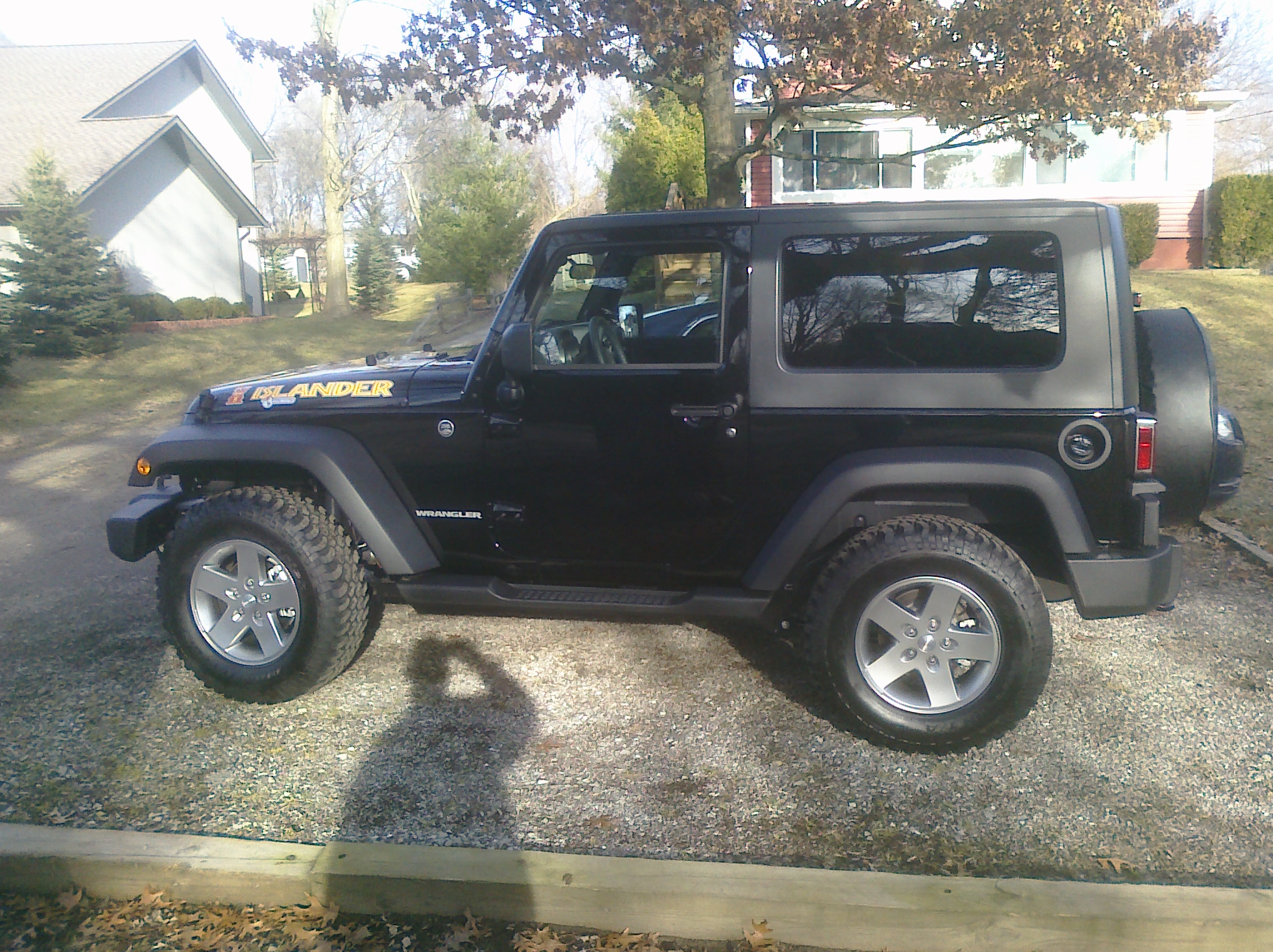

.....did you peel the Islander decals off in the last pic?
Yes I peeled thim off. Dont care for them! got jeep seat covers too. This package had the most rebates so I went with it.
