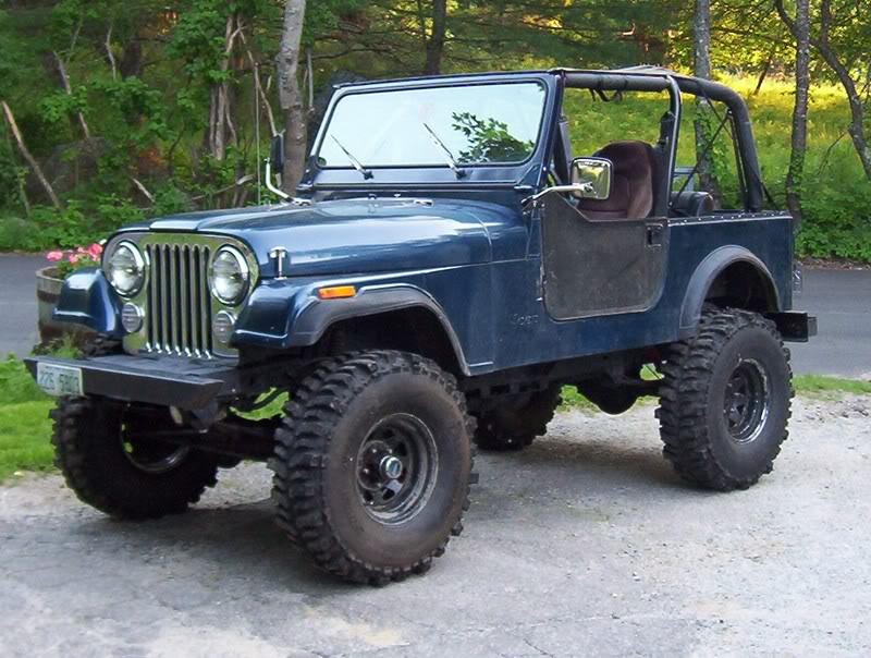

I need to replace the seatbelts in my '85 CJ7 before I can convince the family that this was a good purchase. Was looking for rear seatbelts that might have some kind of harness option (for the kids). Not a 3 point (where would you mount it?) but maybe an "over the seat" harness. Does something like this exist for the rear? If not, I'll just get the lap belts. Can you recommend a solution? Will also need new front seatbelts.
Later in the project I plan to replace the seats - should I just do that at the same time or is it ok to do belts first?
