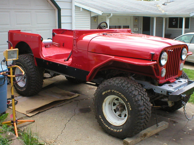

If I remember correctly the fuel pump circuit is working correctly, it turns over slow and does not seam to try to fire. I checked all of the ground and the power wires from the battery with no results. Battery is low and may be weak ,my next trial is a new battery, but even with jumping it turns over slow. I have good fuel pressure (checked with a gauge). Motor ran before pulling it out of the car (drove it into the garage to take it out).
I thought of something while writing this, I may have the wrong computer hooked up to it(I have others from the other motor I had in it without mass air. This might be the issue but I doubt it. I will look up the part number to double check, tomorrow.
