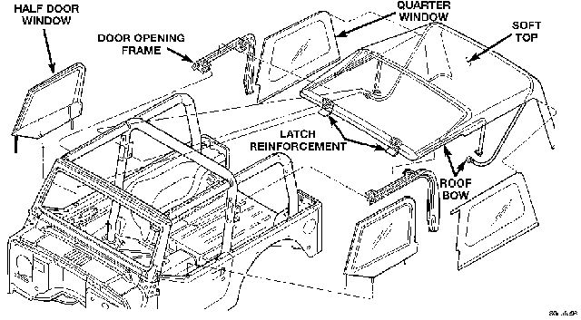

Would this help?
INSTALLATION
  1. Position the top on the vehicle.
  2. Install the screws attaching the roof bows to the pivot bracket. (The front bow is attached to the pivot bracket on the upper outward location).
  3. Raise the top.
  4. Position latch in windshield frame.
  5. Install the quarter windows.
  6. Working from front to rear, engage the J-straps attaching the quarter window to the body.
  7. Install rear window.
  8. Engage drip rail retainers above door opening frame.
  9. Working from front to rear, engage J-straps at soft top rear corners.
  10. Engage the retainers attaching the rear window to the body.
  11. Close latch at windshield frame

Kinda sorta. It looks like my frame is a little different from the one in the diagram. It'd be nice if it were a little more specific. Im sure its simple once you figure it out, but looking at it now, its like a foreign language. Thanks though, hopefully I figure this out.
