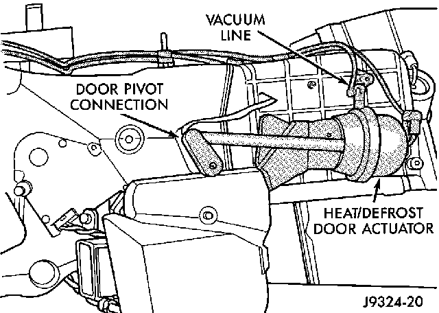

Anybody know where the heater control valve is located on this vehicle? 97 jeep grand cherokee laredo 4.0 v6 4x4, is there a vacuum line somewhere to the heater core to shut the flow of water off to it? I need to check that before I cut a hole in the dash, but I cannot locate it. Any body got a pic of the location please?

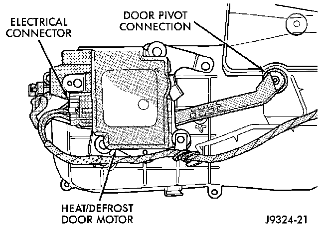

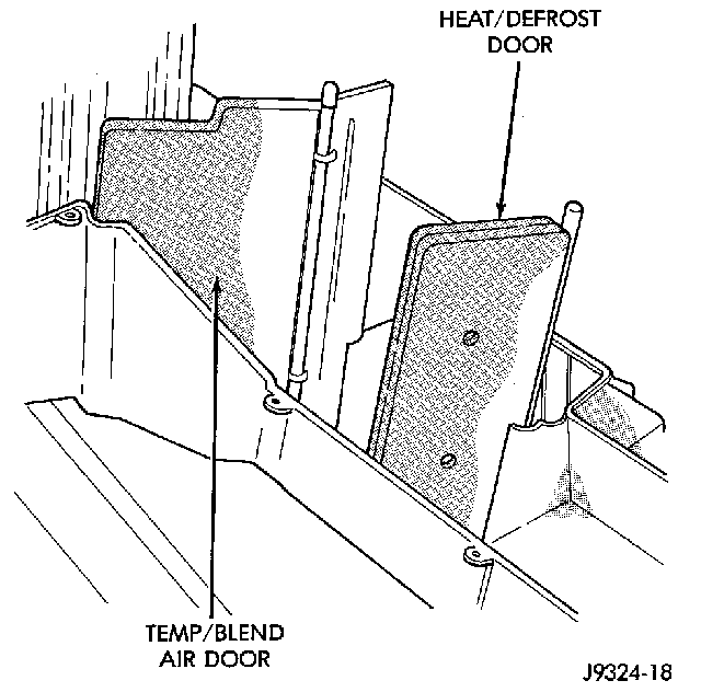

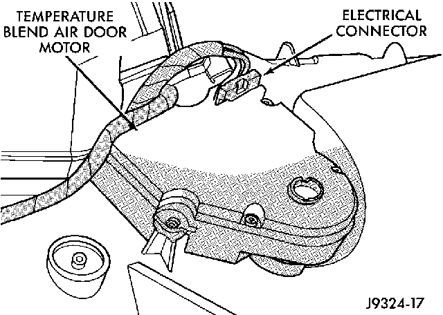

Your GC does not have a heater control valve. The hvac system consis of both vacuum actuator and electronic actuators. Here's some diagram for refference.
Thanks for the information and diagrams, I've determined that it is the heater core. I had it flushed professionally and it must be partially plugged and had an air pocket or something in it. I hooked a garden hose up to it and water flows cleanly, after I did that I have more heat, something that actually resembles heat so its partially working now, yay! it was 27 degrees out this morning, defrosted well and warmed the cabin to a comfortable level. I called and was quoted 550 to repair, so I will wait on that and see how it goes, thanks for all the help.
