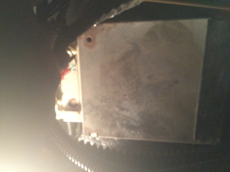

I understand that the last battery was drained so that is why no juice and nothing worked but now with new battery I am stumped. All fuses are good. As this is my first CJ, could the computer (I guess that is what it is called, see photo) have gone bad? I had to move mounting location, could I have done something to screw it up? Never unplugged just removed from holder, moved then re-inserted in holder. It is so dusty it looks like original.
The ignition control module (pictured) will not have any spark at the coil or plugs if it were bad, but the engine would crank. I think you have a connection issue some where or you starter is froze up, I mentioned starter because you say you get a GROAN when you try to start. If you have a volt meter, test the wires at your coil for power, then check wires at starter for power.
