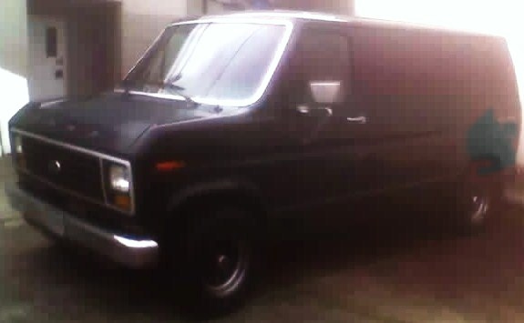

Taking a hiatus from working on Betty, I went to work on "The Oven" my '81 Ford Panel Van.
Got a RMR C475 radar detector for Christmas and thought it'd be time to repair the source of a small short circuit in the headliner when I found that rain was seeping in at the top of the windshield. When removing the trim during the aforementioned repair I must've disturbed the seal. The seal seems to be tar like rope material I've used when I mounted a new windshield in my '66 Chevy.
My question; is this tar like material available? by what name does it go under? and finally where can I find it?
Thanks and a lift of the lynch lid for any responses.

Tried using silicone on my old '66 Malibu, but it wouldn't bond like this stuff. It's so sticky, it's hard to get off yer fingers. I just don't know what it is, or where to get it. Going to try a glass store locally but having dealt with them before they want to do the work themselves, great for them but not so for my wallet.
Holy schneiglies! A local glass shop says that because the windshield is so old I have to replace the whole dang thing at between $400-800 clams. I think I'll just have to keep a sponge handy.

Ahhh, got a friend at another glass shop that was able to pull the old windshield and got rid of the butyl commonly used in those years using up to date sealant, hasn't leaked since.
