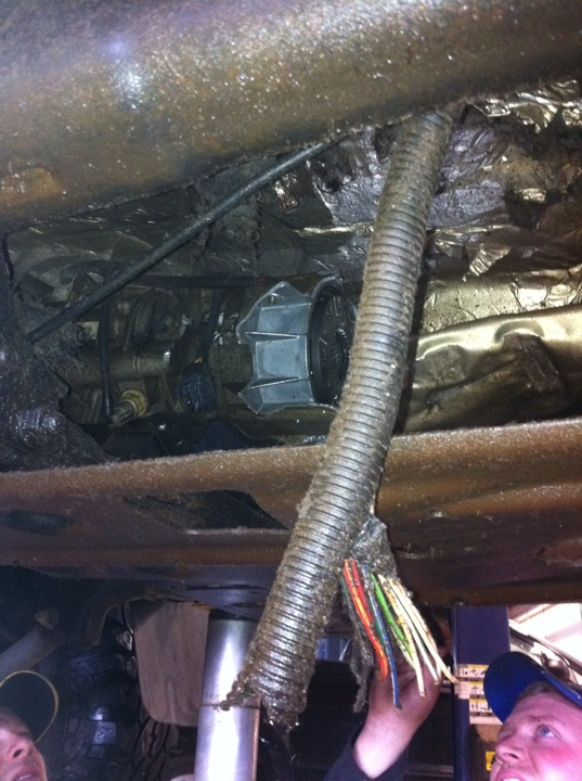

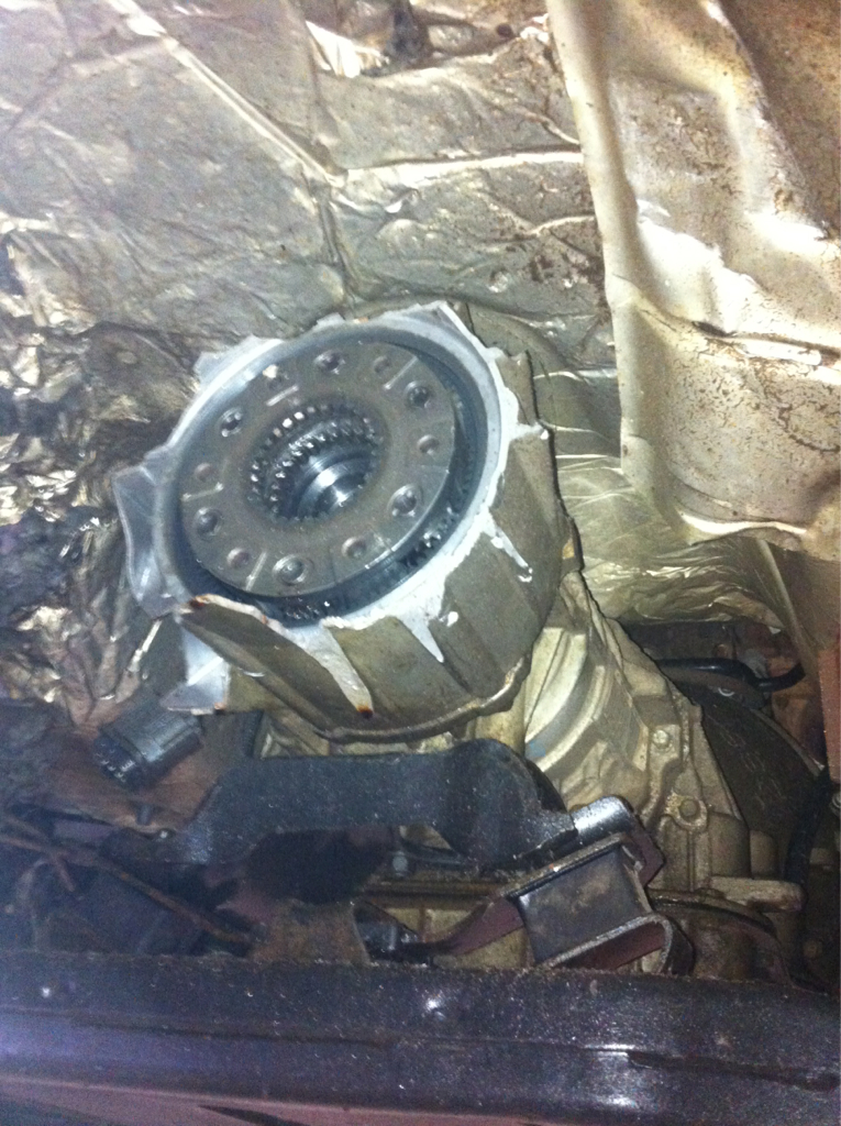

Heres a pole vaulted t case on a truck in my shop. Front u joint broke. And dug into the ground. That's why only the planetary of the t case remains lol
2010 ram 2500. He was doing about 45. He was in 2 week prior and didn't want to spend 250 bucks. This repair was over 8500.
The picture on the left,Is that the main wiring harness?:shock:

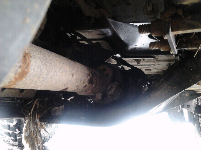

I think what happened was the bad u-joint caused the drive shaft to wobble so much that it wore out the bearings in the front of the case... causing the yolk to wobble out of control... then on one of the VERY few days that I actually needed my 4wd, it cracks in half at 55mph on the highway... 2wd still works but the front shaft sounds like h3ll because it's still spinning
I think I attached a photo
