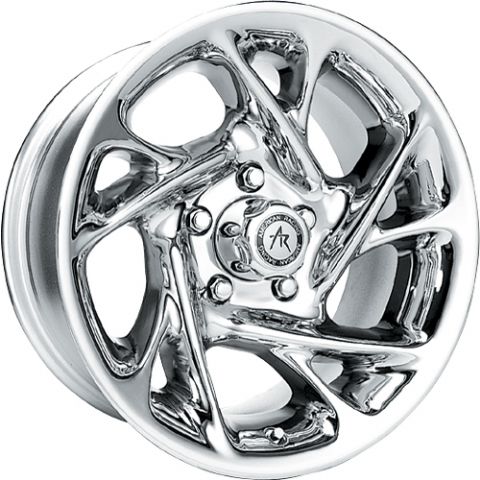

Today was a pretty hot day in Salt Lake City, UT, probably upper 90's. Well I was driving with my wife and a couple of her family members and when we got to her sisters house my jeep was just over 210*. I let it sit for a little bit and then popped open the radiator. There was coolant in it, but it was kinda low. The person that owned it before me didn't take care of it so there is no over flow tube going to the coolant reservoir. Add that to the list of parts i need. Luckily though i added some water too the radiator to limp it home to Orem which is about 45 miles away. Now one of these days after work i gotta tear into it and remove the thermostat since it seems as if its going bad. But at my sister-in-laws house i scored some free american racing nitro wheels.
they have a small amount of curb rash on them but they are still good. They are the steel or aluminum, not the chrome. Now i just need to get a set of new tires and ill be good to go.

A quick way to detirmine aluminum from steel is using a magnet, steel is ferros so the magnet will stick, not so with aluminum. More obviously, aluminum rims are considerably lighter.
