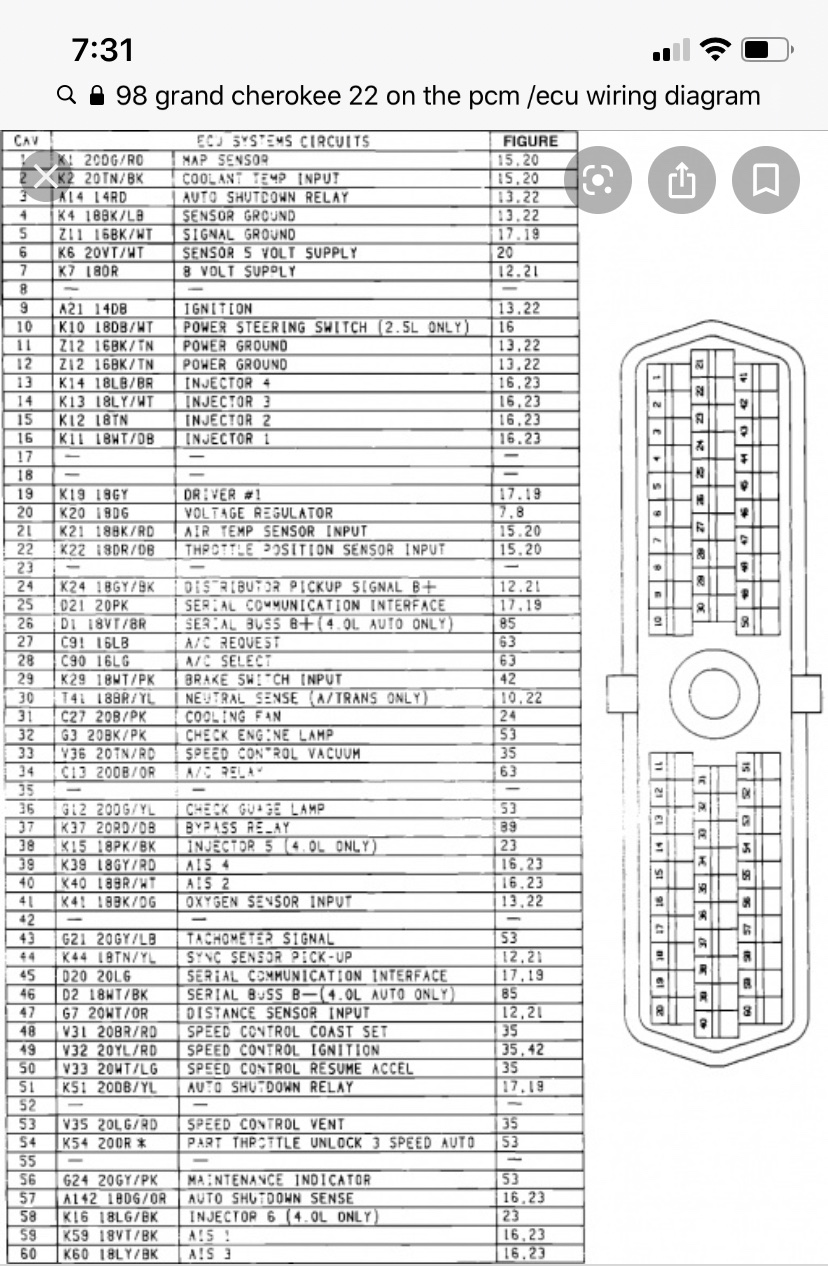

Mikentina New member May 1, 2020 #1 Ok so all the pins that i went to test were either right on the mark but when i tested pin #22 on the pcm for 12voltz it came back with 7.4 voltz 98 jeep grand cherokee laredo 4.0 zj
