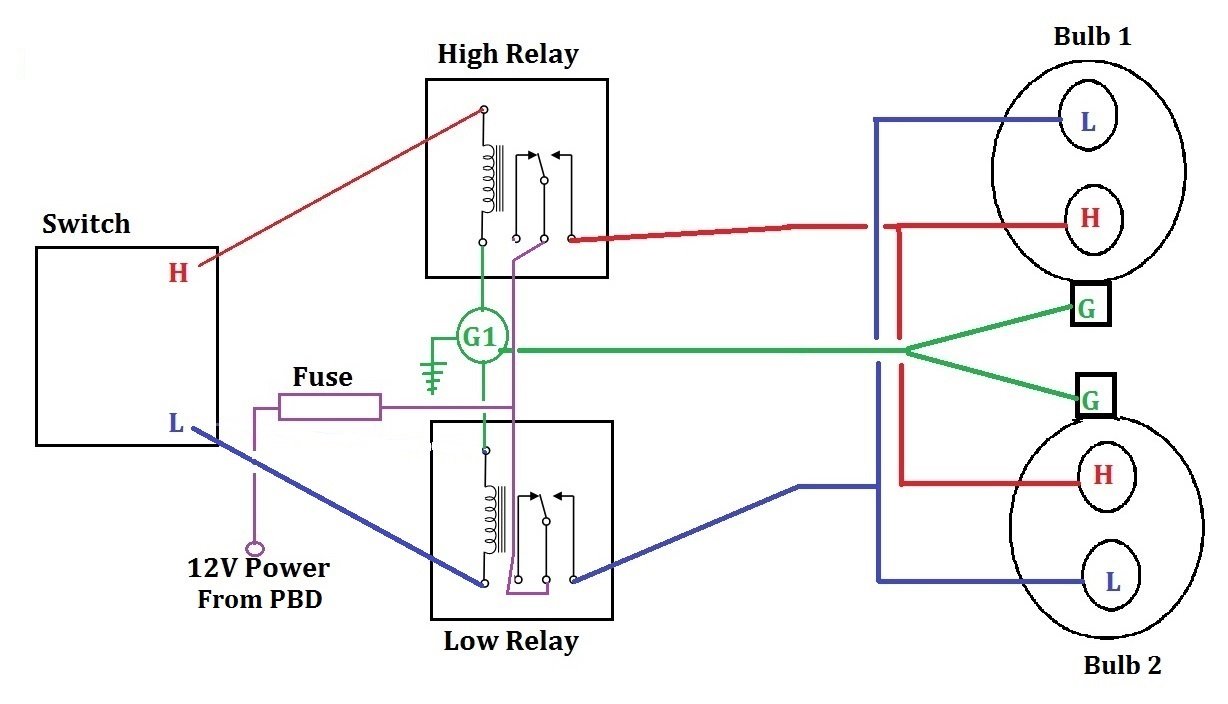

How about a basic sketch of wiring? Number the pins accordingly. I'm guessing look at the high beam pins 85 and 86. 85 ground and 86 signal from high beam if low 85 ground is connected to high 86 signal this may create this situation.

This is an approximation of the wiring;

The wiring looks good. The only question is the G1 point. Is that a single point? Or is it seperate points. If a single point a bag ground can allow voltages to float and keep the relay closed

This is a new Multifunction switch, but give their design, I don't trust them. I have most of the underhood grounds going to a bus bar that connects with an 8 gauge cable to the negative battery post.
