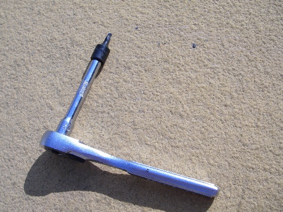

01 You will need a T15 attached to a ratchet.

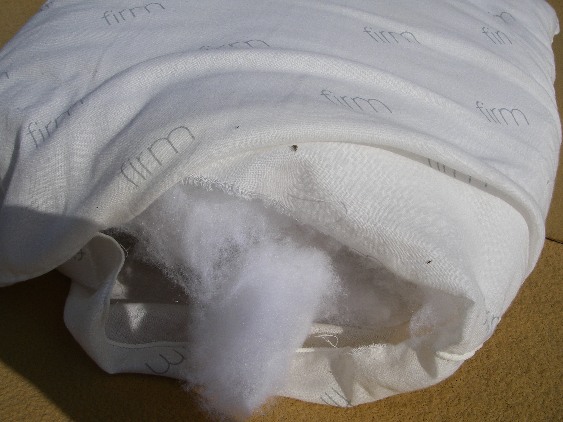

02 One Polyester fiber pillow it should be 50% Polyester and 50
% Cotton, Cut open and pull out the guts.

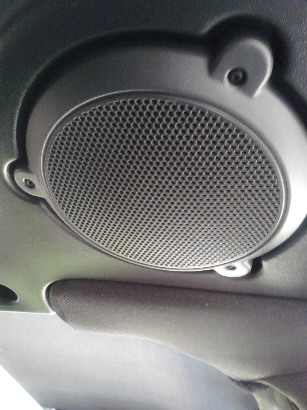

03 Remove the 3 T15 screws from the rear speaker.

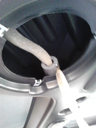

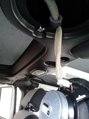

04 After the screws come out hold the grill so it dose not fall. Than just let the speaker hang.

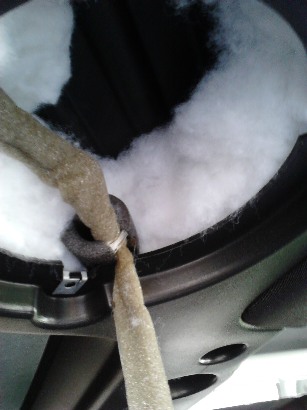

05 Stuff the sound bar till it is full. And do the other side also.
