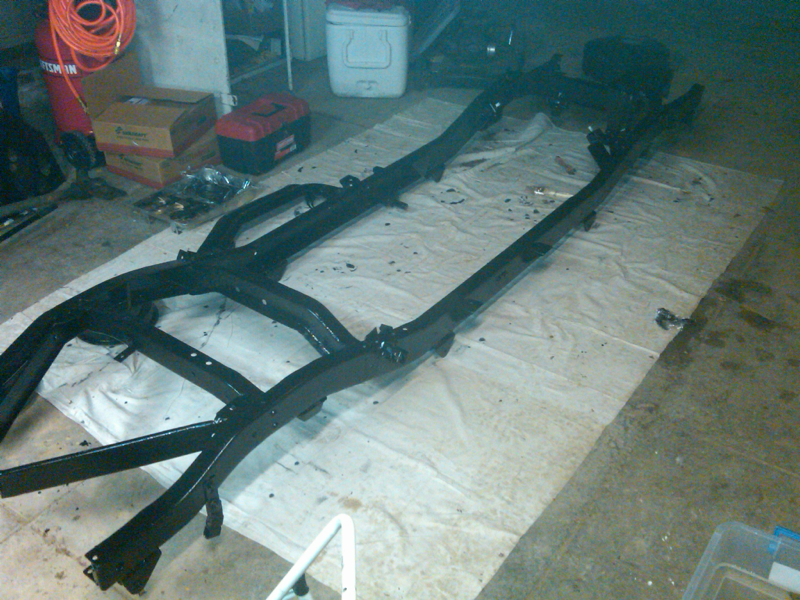

Can you upload a pic of the frame so I can see? I'm gonna por15 it then Herculine it because I heard the herculiner will hold water
I used POR-15 on my frame and top coated with POR-15's Chassis Coat Black top coat. I sand blasted it all first. Came out beautifully!

I won't paint another frame with paint. I have done that in the past, sand blasted, por15, chassis paint, and it got chiped and rubed off while off roading within a couple years. started using bed liner on my frames.
I'm thinking por15 and Herculiner will be a goo direction to go
