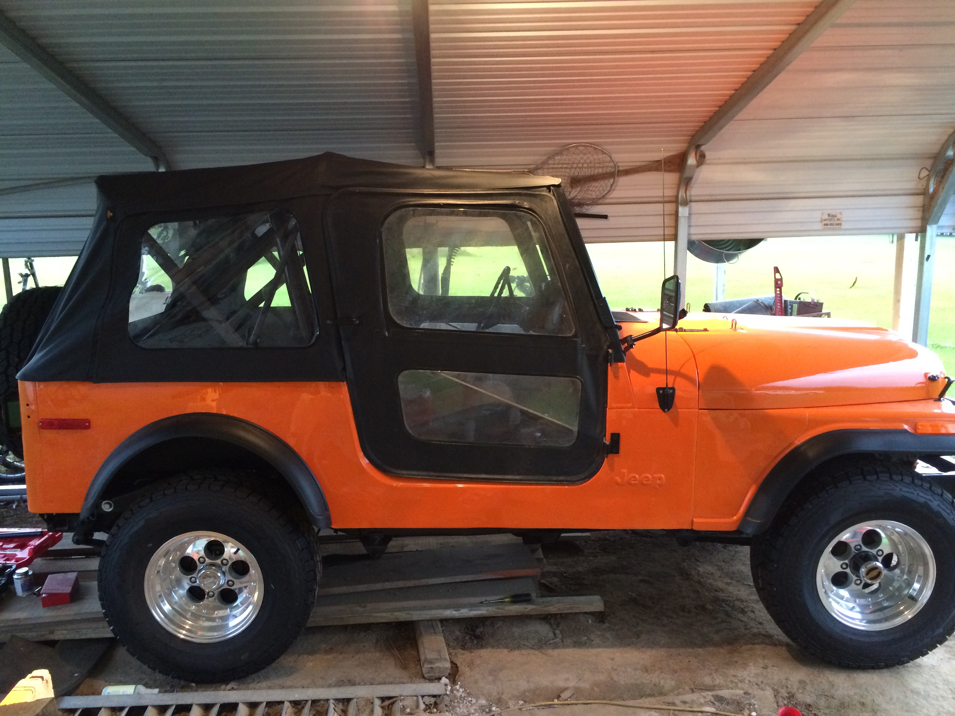

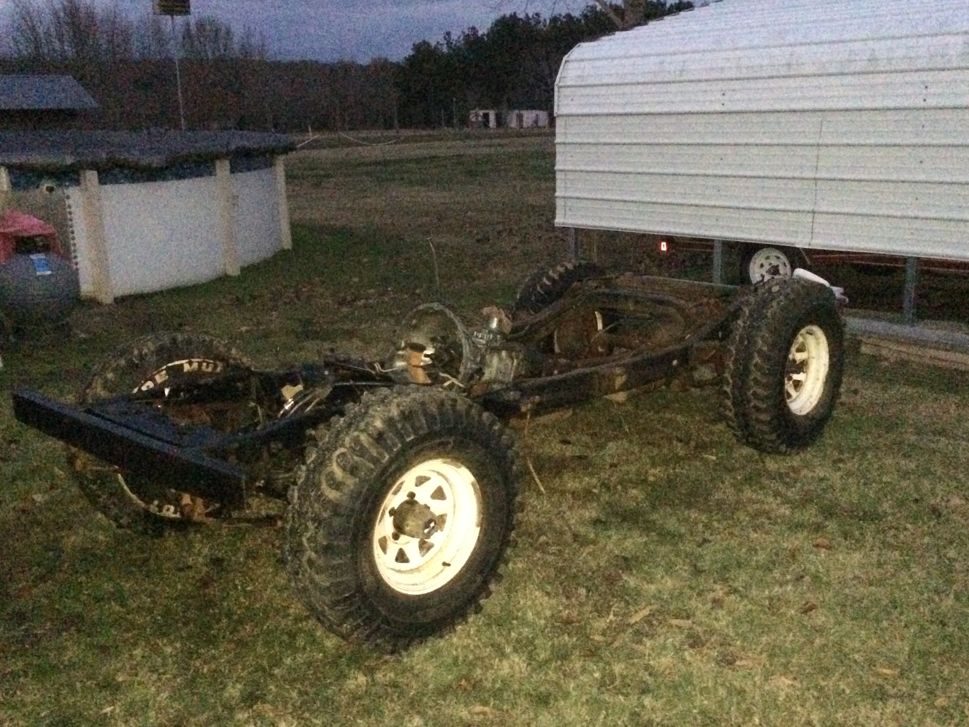

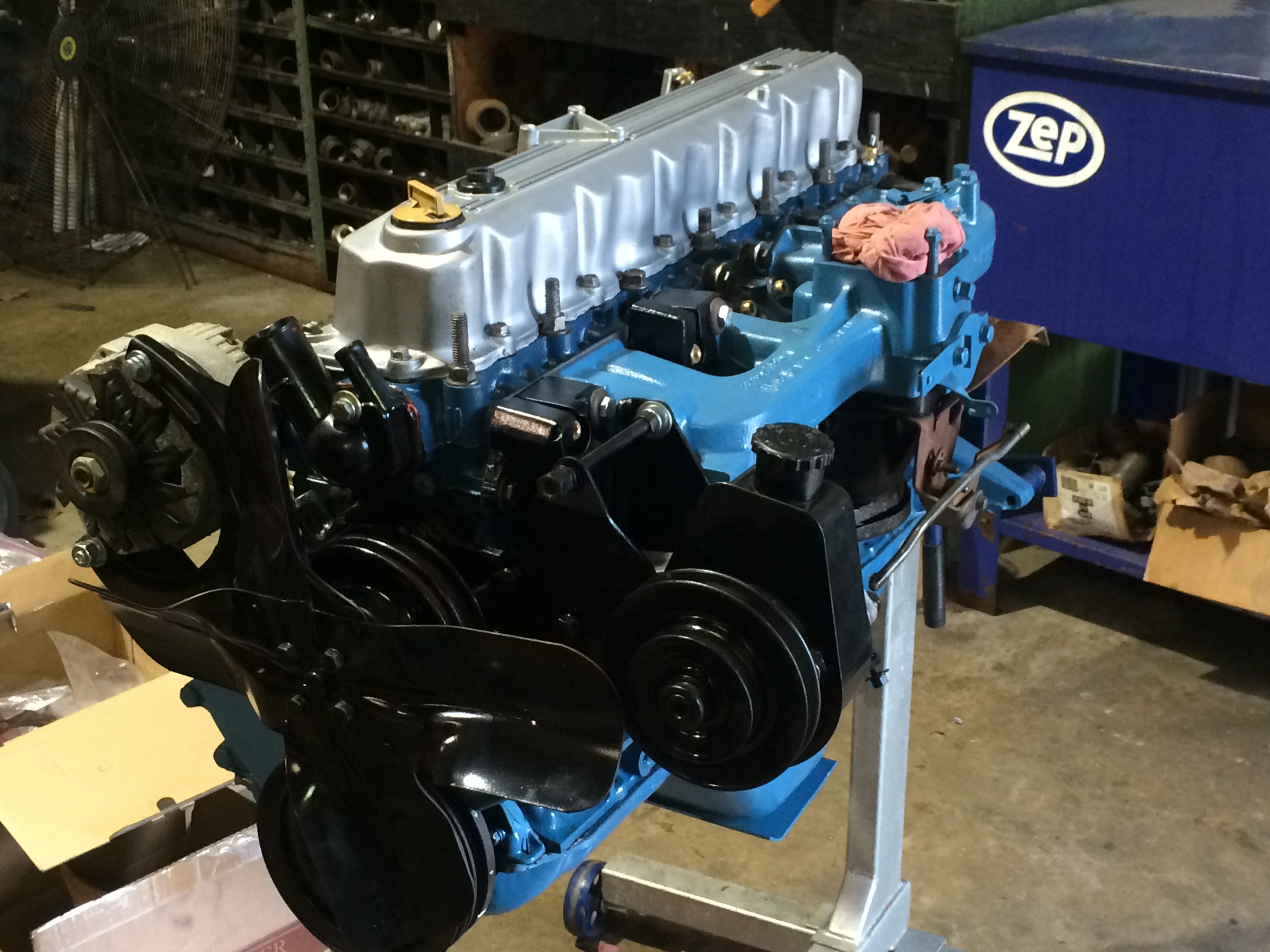

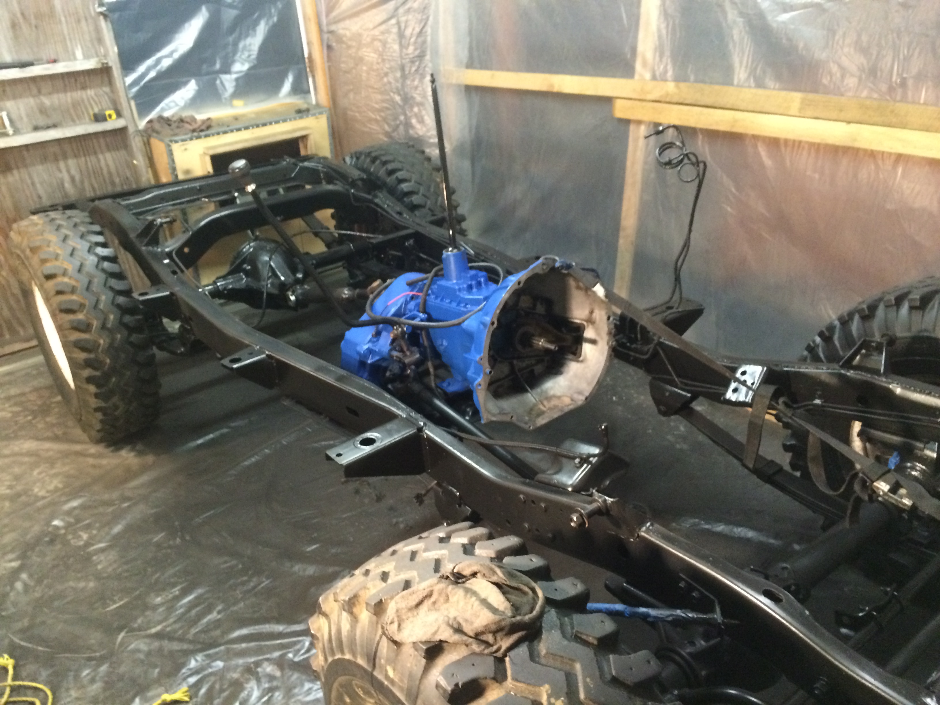

Thanks for the info Guys. This is all good stuff and discussions with people who have already done projects you are about to take on is always beneficial. Everything in this jeep is new. I screwed up royally!! Man that hurt! I bought this jeep a couple of years ago and did a frame up restore (My First). I took the PO at his word when he told me the transmission was in good shape. This was a 70 year old guy who came off very likeable and gained my trust while talking to him about the jeep. The jeep didn't run when I got it, but shifted through all the gears with no problems the day I looked at it and with the new engine running. Once I was able to take it for a spin I realized my mistake and what a mistake it was. It could win a blue ribbon for appearance (which it won't), but if it won't roll down the road then it's quite useless, right? Well that's where I'm at, but I'll eventually get there. I still have few lose ends to tie up then tackle the transmission.
Thanks for the pics ! Real sweet ride ! I totally appreciate anyone who puts this much pride into restoring a CJ . I still feel and always will that the CJ must be preserved . Without it , the off road life style would not have gotten to where it is today . Sorry about the trans snafu but you know the t176 is a reputable trans and well worth a rebuild . Looking forward to hearing about its completion when you can and I know you'll be anxious to drive this beauty too ! Best of luck !
Don't beat yourself up over missing a problem or two....that is an awesome looking CJ. Soon you'll be enjoying driving it, and in the meantime remember, Jeep work is good work!! Enjoy the garage time!

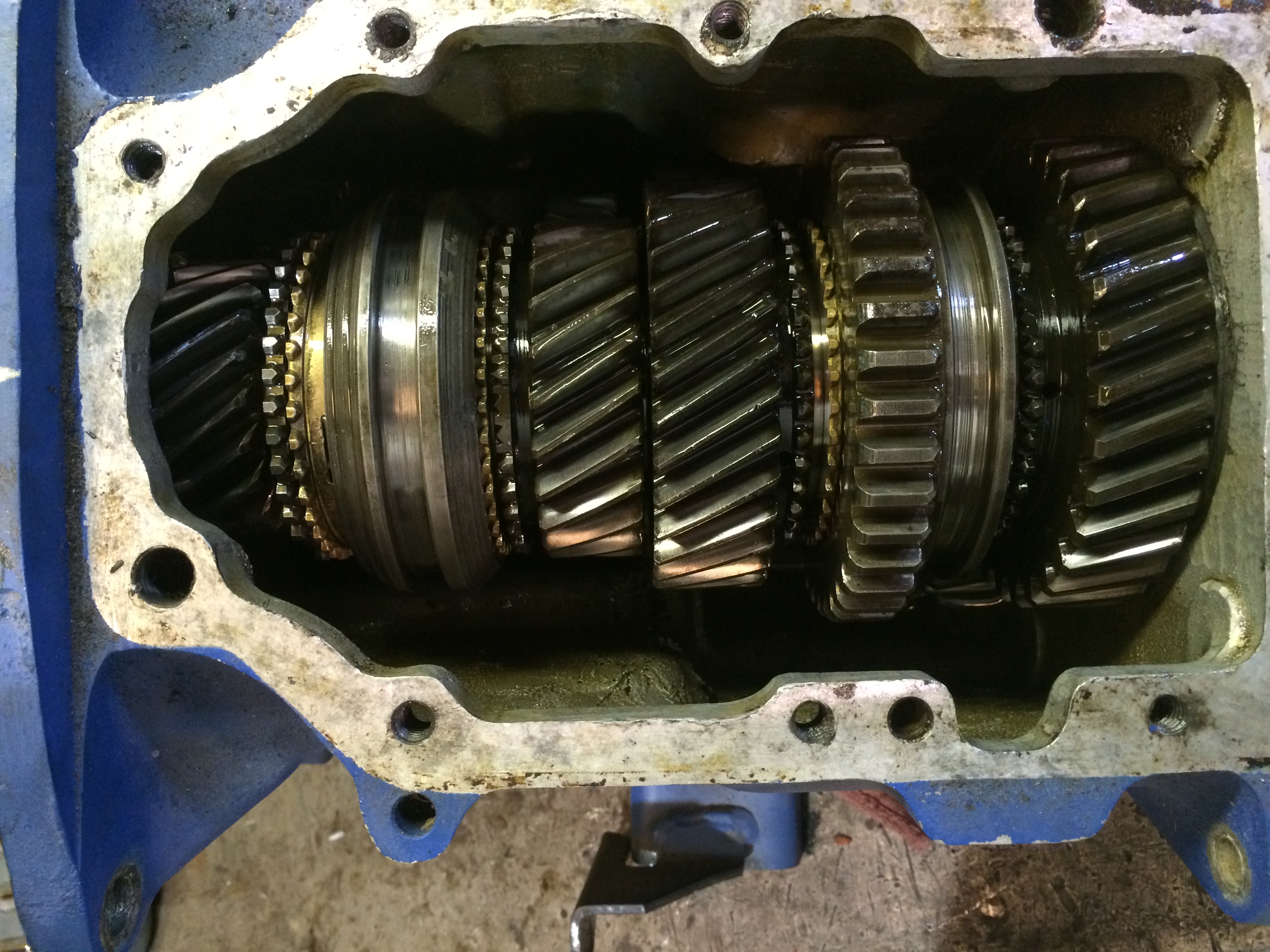

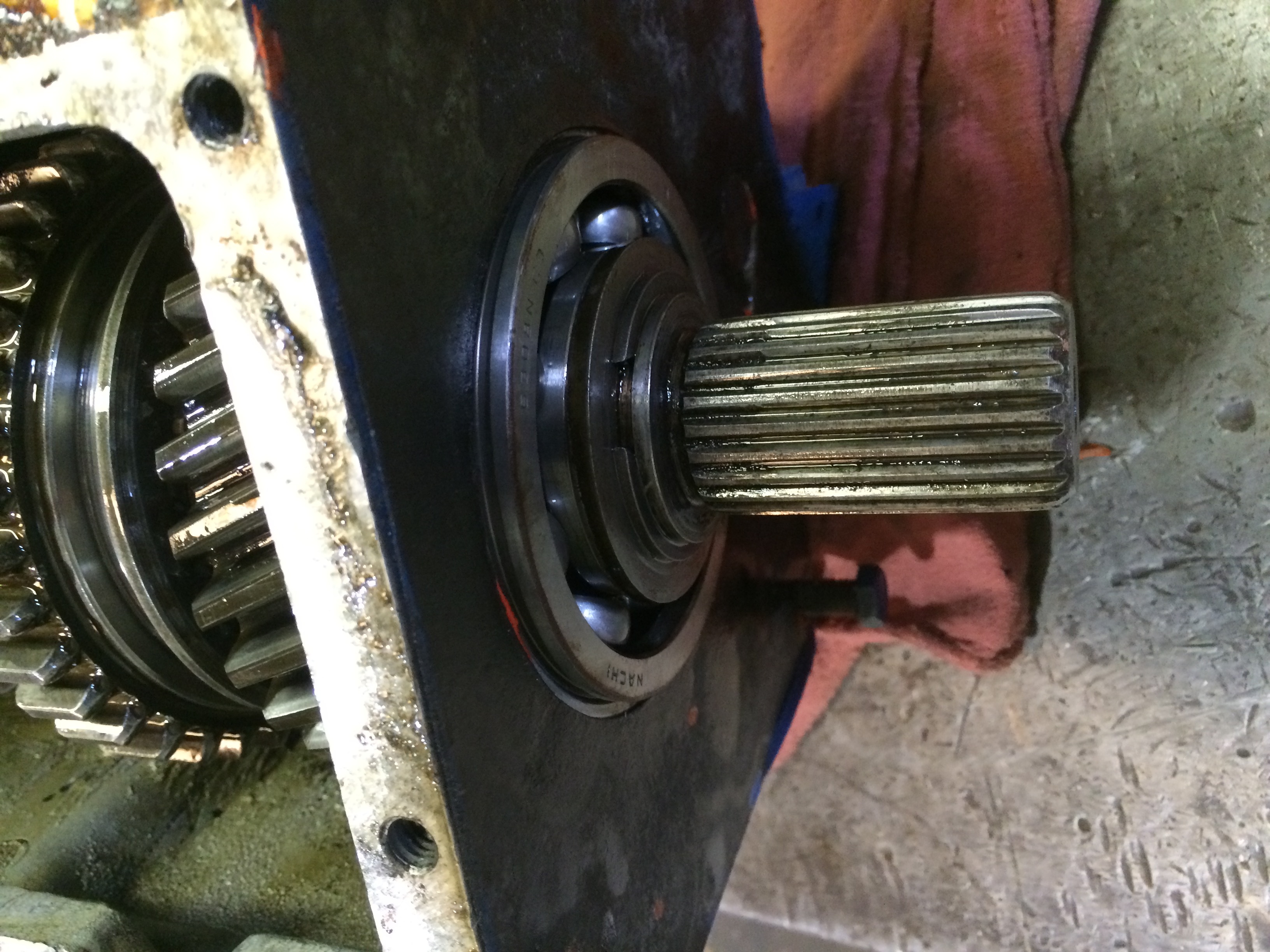

I wanted give an update on my progress. I pulled the transmission Thursday. You all were right it wasn't nearly as bad as I thought. Although the three bolts on top of the bell housing were very hard to get too. They will be a bear to get started and torqued on the installation. Thanks for all the input. I have the transmission on the work bench with the main shaft ready to go back in. I also installed all new shift forks. I'm waiting on a reverse gear to be delivered. It's supposed to be in Monday. I can then complete the rebuild and get it ready to reinstall.
Thanks for the update . Great to hear the job has been going well. Nothing to fear upon reinstallation , you've got the experience . Every job always has it's easy and tough moments . Looking forward to a great running jeep soon , just as you are . Hey , how is the clutch assembly ? I did mine even though I didn't plan on spending the money just then but no one likes doing the same job over unless it's necessary . But it's a jeep and eventually a clutch replacement will be necessary someday. At least you've got the job down experience wise . One bolt at a time , be safe .
