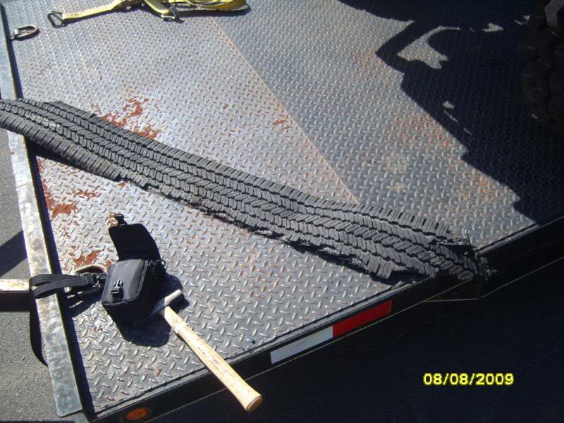

I found the best deal on tires to be Northern Tool, you'll probably need at least a 2000# rated tire, most likely a 205 75-15R, and make sure they are trailer tires, lt truck and or pass. car tires will not cut it, this happened to me this summer, my spare tire was a lt truck tire, I had a flat and had to use it, this happened on the highway at 70 mph. not fun.
