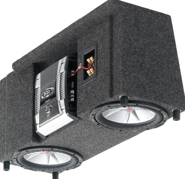

Hi everyone. For my first post, I have a question about the quality of quadratec subwoofer setups. I am planning on buying this in the next few hours BUT, I'm not 100% sure if this set up is good for my TJ.
Custom Rear Dual Subwoofer Kit with Kicker CompVR Speakers & Boss 850 Watt Amplifier
Quadratec Part No: 14136.361
Manufacturer Part No: JW-210CVR
(see attached image)
Friends tell me kicker subs are great...
I see no specs or model of amp aside from knowing its 850 watts boss i know nothing else. It could be peak power or constant... no idea. no mention of ohms either.
Basicly, I want something that i can feel a bit while going down the highway ~60mph.
Quadratec staff said it can be bolted in with the backseat in place too... So thats quite a plus. But my question is, is this setup really worth the 700.00 plus shipping? Or should i hit up my local custom car audio shop? (i'd hate to do that after the $450.00 slop job they did on my alarm setup)
I have yet to meet anyone who has this setup. I dont know if thats good or bad.

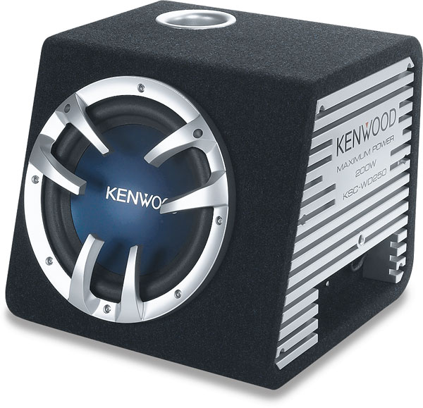

Ah, I forgot to mention, It will be replacing a 200w Kenwood KSCWD250... (see attachment).
The kenwood works great, but I cant put my backseat in while its there... and it calls too much attention with the sub facing forward and the (imo) flashy grill and silver port at top.

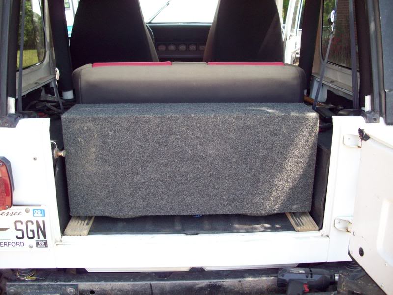

$700 plus shipping is alot of money for that setup, but it does look like a nice box. I'm not familiar with the name Boss, but I'd say that that amp is 850 max, not rms.
Do you need any storage space? It looks like that box will use up your entire behind - the seat storage.

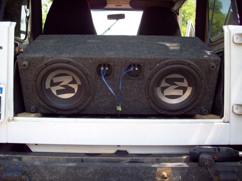

I have a box very similar to that with the amp mounted under the seat. I'm not a fan of mounting the amp to the box due to the vibrations speeding up the death of your amp. It also looks like that box is a single chamber which I'm also not a fan of. Let me look for the brand of my box here in a minute but I put my system in for less than 700 and if you need help with installation I can provide you pictures of how I did that too.

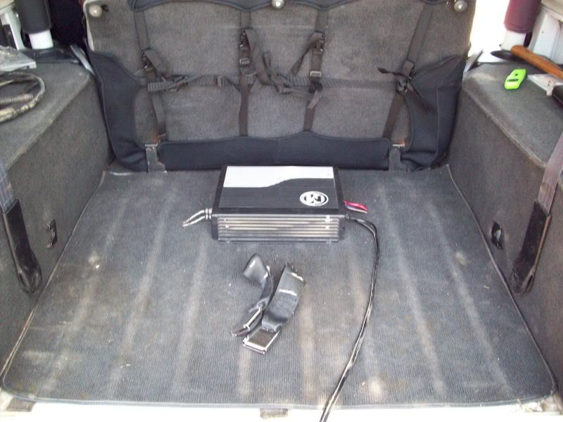

here's the amp bolted to the floor under the seat
The bottom of the box
How it sits behind the seat

850 peak is nothing like 850 rms. That amp won't really push 850 watts - it will really only do 200 watts consistently:
Boss Audio GT1000M Riot GT Series MOSFET 850-Watt Mono Power Car Audio Amplifier
I definitely wouldn't buy the quadratec setup with a pathetic amp like that. The amp is the most important part of a clean sounding system, followed closely by the box, and finally the actual subwoofers. It's alot harder to overpower subs than it is to damage them with not enough power.

just got word back from quadratec. It appears that sub box setup does NOT bolt to the jeep. And its an open chamber. hmm.. meh. more research.

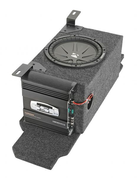

Any opinions on this box ?
Quadratec Exclusive -SUB03-CVR - Custom Rear Subwoofer Kit with Kicker CompVR Speaker & Boss 850 Watt Amplifier for 03-06 Jeep Wrangler TJ - Quadratec
That's a much better power setup. The same amp running 200 watts continuous but to only one sub. I just wouldn't run two subs off of it. Kicker is a fairly decent brand and the cone is a "injection molded" (plastic that will take better to the rough conditions of a jeep lol). A quick google search on the vr10 shows good reviews and looking at it's specs it seems to be matched with that amp fairly well. If there's a way you can find out the specs on that box I don't see them listed on quadratec's site, but the sub calls for a minimum of .8 cubic feet and a max of 3 cubic feet in a sealed box so if it's between that you're good.
