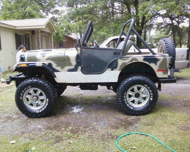

79 cj 5 pic
Might just be me but that doesn't look anywhere near 10" of lift. Kinda funny with the chrome rims and rattle can camo paint.
