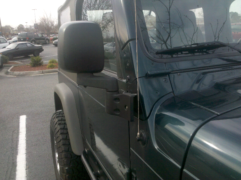

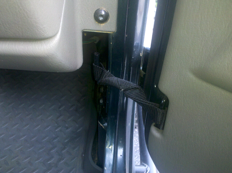

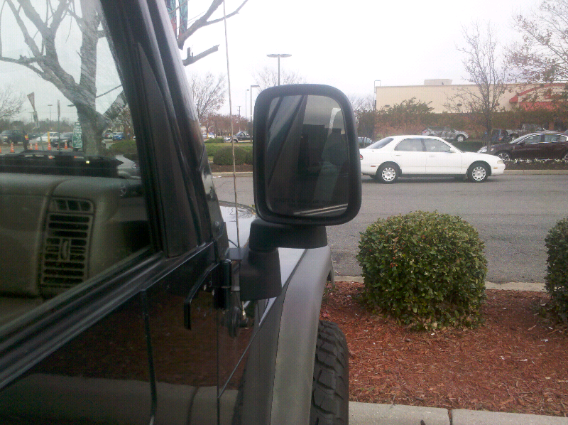

I use the sun performance mirror movers and like them (I did a writeup in the reviews section). If your doors are hitting your mirror when opened then you need to adjust your door straps. With the doors on the jeep, take off the strap where it mounts to the body and twist it 3 or 4 times. This will shorten the strap.
Sent from my DROID2 using the Jeepz.com app
This is what I use
