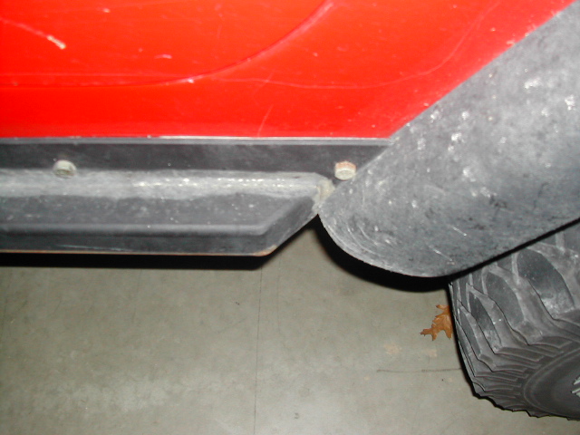

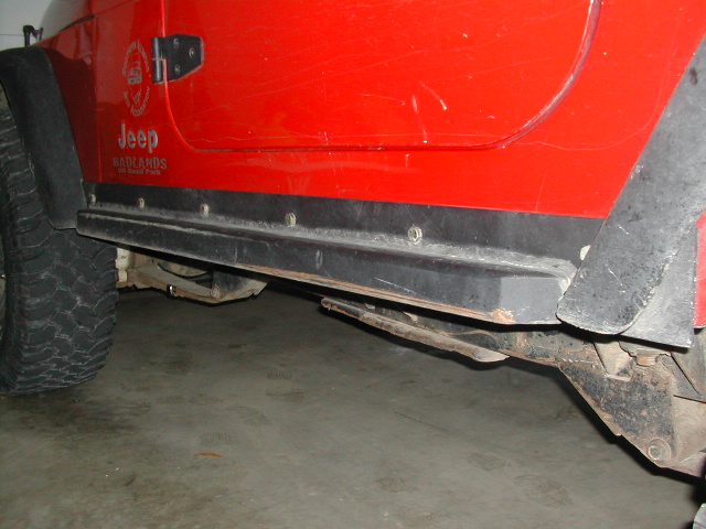

Here's mine, there's a lot of options with 4"x4"x.25" angle iron.

Quick question regarding the custom angle iron rockers (I've got the machine shop at school making me a set - nice call Tug with the angle iron!). Are there specific locations you should or shouldn't bolt these bad boys on along the frame? It appears from the posted pics that the holes are just spaced out along the panel. Thanks for the input.
Cheers,
Geoff

No. A good friend of mine has went into business making these, and he ties his into the body mounts. Not a bad idea. but mine have taken a huge beating with no problems.
As for where to put the holes, most importantly make sure they are above the floorline inside the tub, or you'll be drilling into the floor. Leave enough room inside for a large fender washer.
It's a good idea to have the forward most hole into the front fender, then you're tied into the body on both sides of the firewall which will be stronger. The rearmost hole goes all the way through the boxed seatbelt mount, a very stout area. Takes a long bolt, but it's stonger this way.
