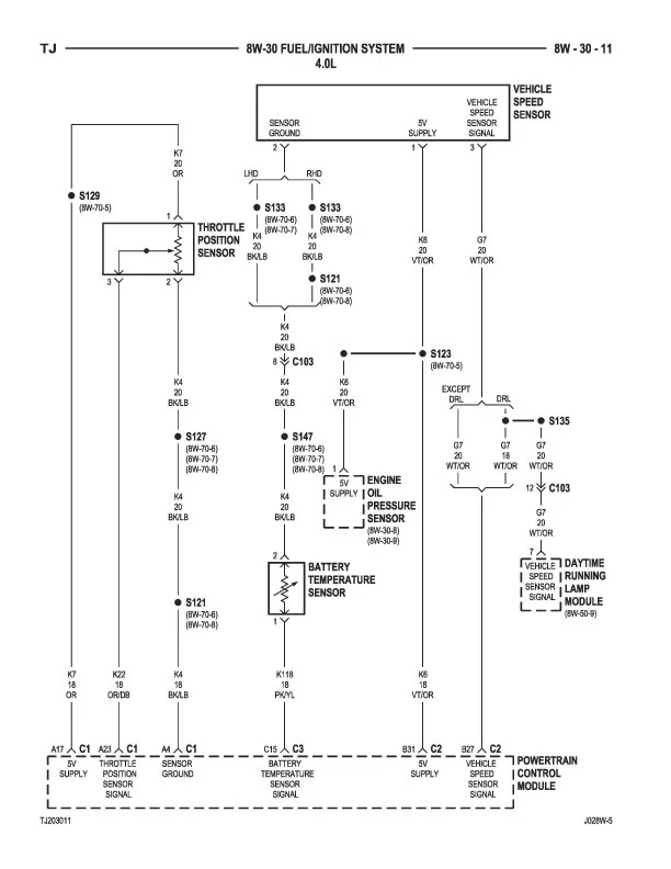

So THAT'S what's going on. I've noticed a lot lately that even when it's running normal-ish whenever I would pull up to a stop sign/light it would hover at 1100 - 1200 RPMs, then as soon as the Jeep came to a total stop it would start to stall. Still don't understand how just slightly rolling still keeps the RPMs high, and that when it's fully stopped something kills it. How does the Jeep know it's fully stopped?

Oh, sorry, it's a manual. That's where I'm confused, I can't think of any way the Jeep can tell it's in motion, but plenty of times when I roll up to a stop it'll idle high right until the second I stop moving, then drop back to normal. I can't figure out the sense in it.

Speedo gear.
What to happen?? The near stall when you slow below 5 mph?
Happened on mine when I cleaned the TB and didn’t plug it in correctly. Happened on the patriot we own and the liberty when it failed.
