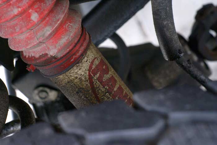

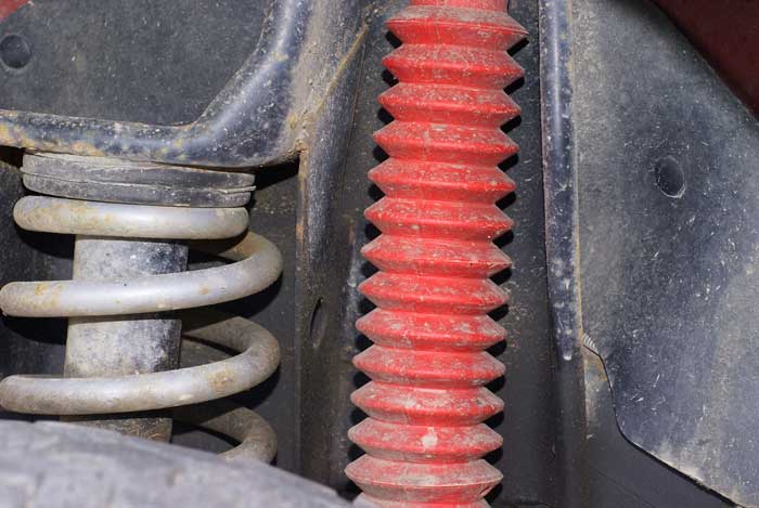

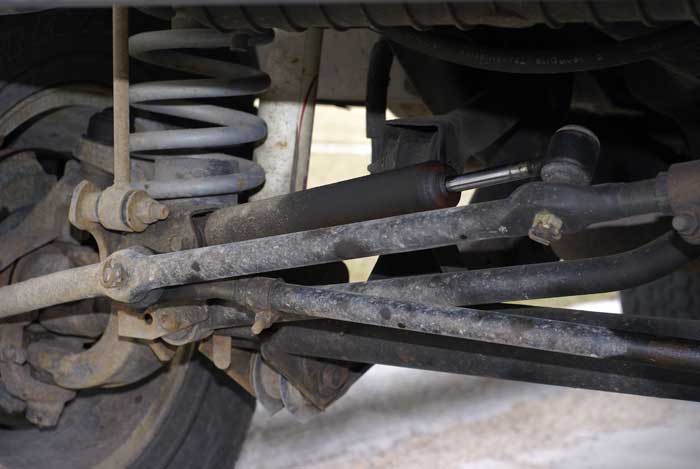

I finally got the camera out to take some pics...
Hard to see the control arm angle, but I would say they are probably fine. RE would not sell a short arm kit for a 3.5 lift if it was going to cause problems. I would look at doing a shock replacement. Looks like oil around the shock boot on the first pic. They are probably shot. For sure you need a new steering stabilizer. That thing looks beat. When you do a lift, and go to larger tires, it's a good idea to beef-up the SS from stock. Also, my personal preference, don't use shock boots. They collect dirt and moisture, and shorten the shocks life-span.
