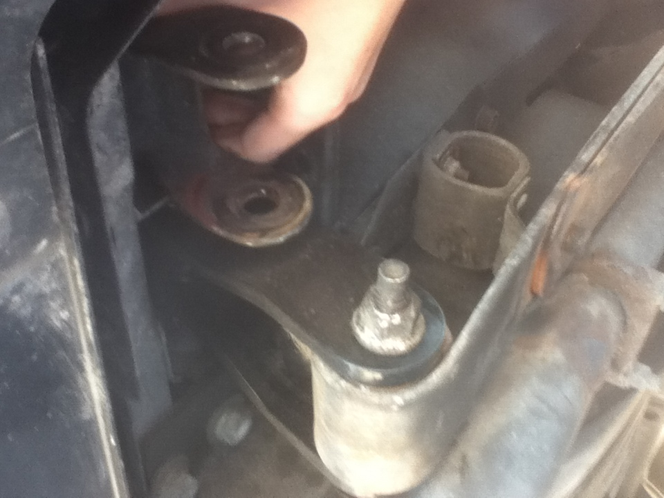

he is right, here are my stock shakles next to the bb 1.75" lift shakles i just put on (im holding the old ones up lever to where they would be mounted
(note these are in the rear and are the greaseable ones)
