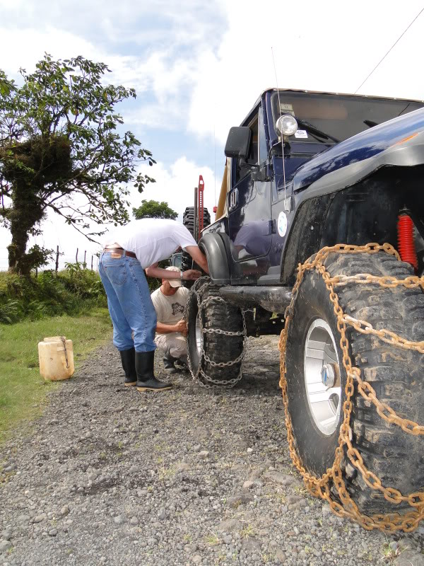

Jfrabat... Your cheating... Tire Chains
JK I use them for snow wheeling every now and then, but I am sure you don't have snow wheeling in costa rica.

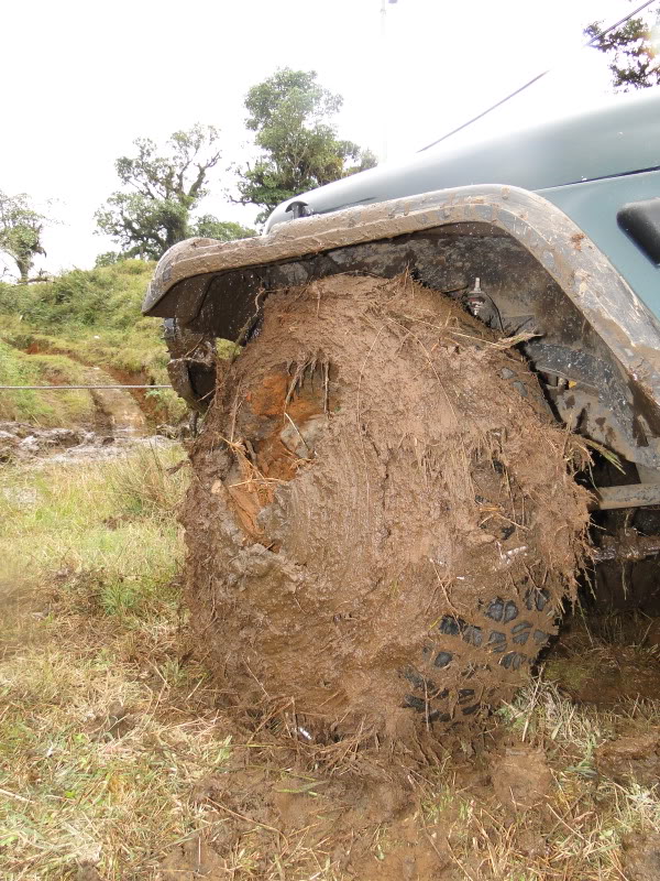

Defenetly not so much snow around here... But sometimes the goop gets SO thick, not even MT tires work anymore. Hence the chains...

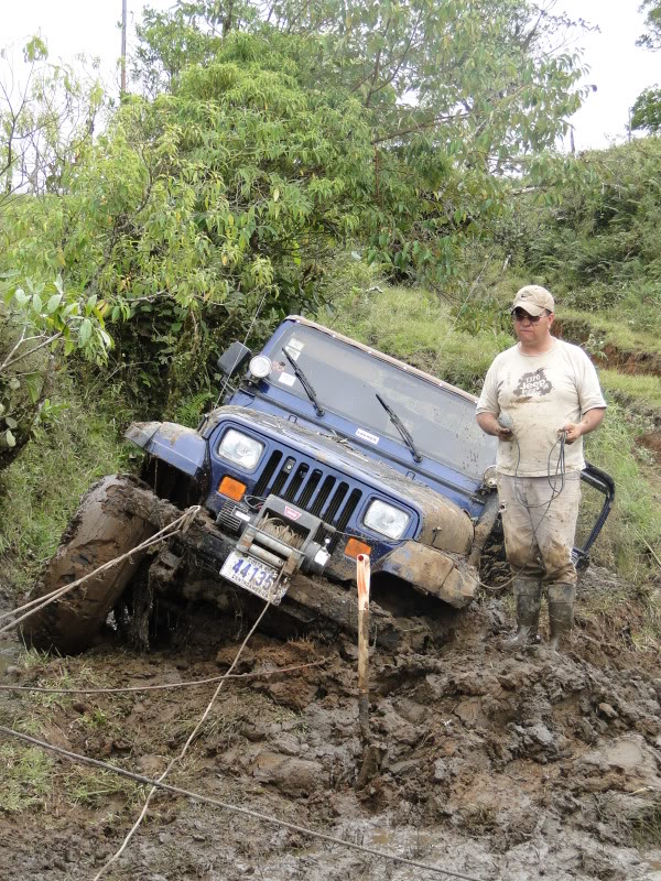

Actually, if you notice the stuck Jeep, he's running 38" Super Swampers Boggers WITH chains (and even with the I6, he STILL got stuck, and it took 3 hours with winches with pulleys to pull him out).
