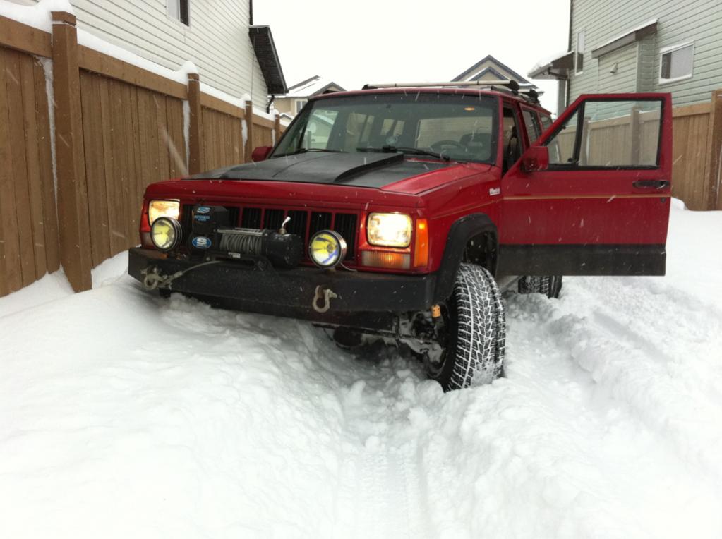

Some advice from me. Is take the time to learn your jeep. Keep your distance from other traffic. Tires are everything. Deep snow mud tires work great. Slippery streets mud tires suck i run dedicated winter tires most of the winter. Nice thing about snow is if you get stuck you can usually back out. Just have fun. Be safe. And take your time. As for 4x4. You can run it on the streets as long as they are not completely dry.

Its all in the rubber compound. And traed design. Summer. Usually hard rubber to deal with heat and hot pavement. At is similar but slightly more aggressive. Winters use a soft compound that stay soft at sub zero temps. They have lots of siping to bite to ice and large voids to get rid of thick snow.
