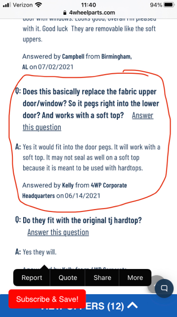

So I have a soft top with the half doors, thinking about going to full doors or maybe the half fiberglass uppers with windows that slide. The manufacturer says those uppers are for hardtops…. Does anyone have full doors with a soft top TJ that can post pictures here on how their doors look? Like do you have that surround thing to seal the door to the soft top? Basically making sure I don’t have to do some serious modifications to make this work.

See images and read review here
Shake n Bake
Yeah those are the ones I am looking at but they told me they are made to fit hardtops. I assume I would just use my surrounds that I have now… I just am not 100% sure
Idk. The review states softtop.
Who is “they”? The manufacturer?
Bestop

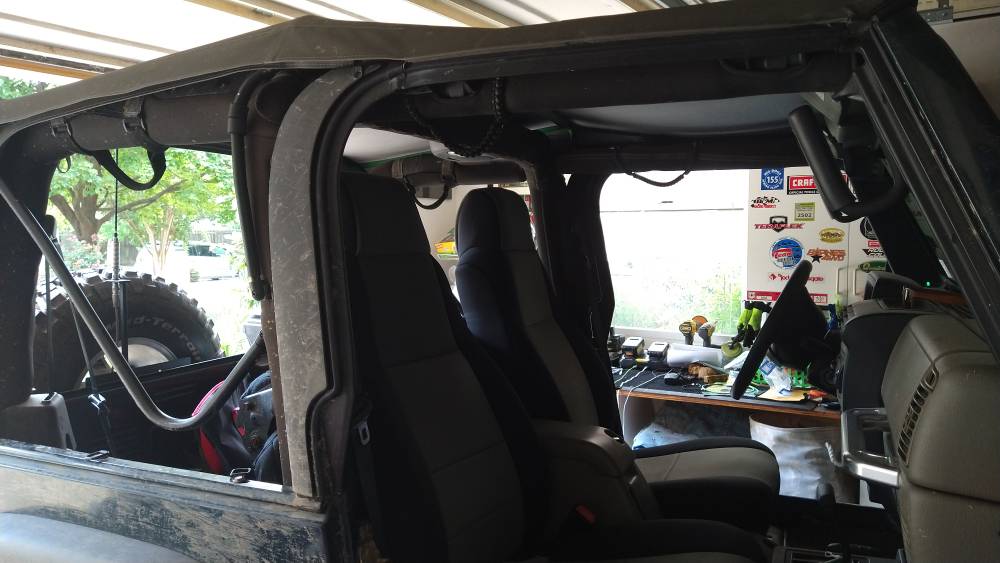

I have a soft top with both full doors and half doors with soft uppers. Here's what my door surrounds look like.

This was my question and then you see their answer… that’s why I am asking real people how does theirs fit.
Those are exactly like the ones I have. I would show you a picture but the Jeep is in the shop getting a clutch. So that is awesome then, if your surrounds work with your soft top full doors then I am confident these window doors will work on mine! Thank you a million for sharing!
