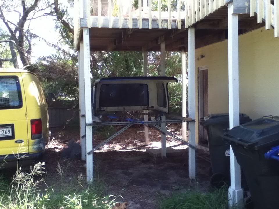

first, you have to remove your current top. for me, it was the ol hardtop. i had to also find somewhere to put it since i am tires of it being on the ground.

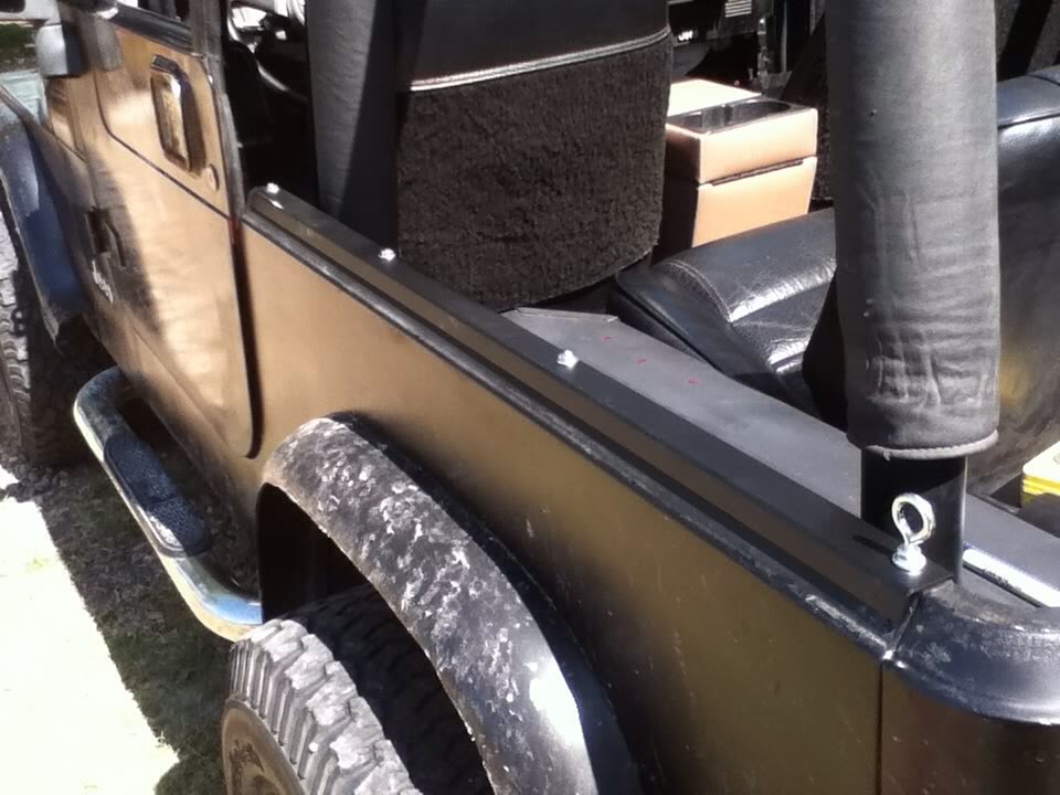

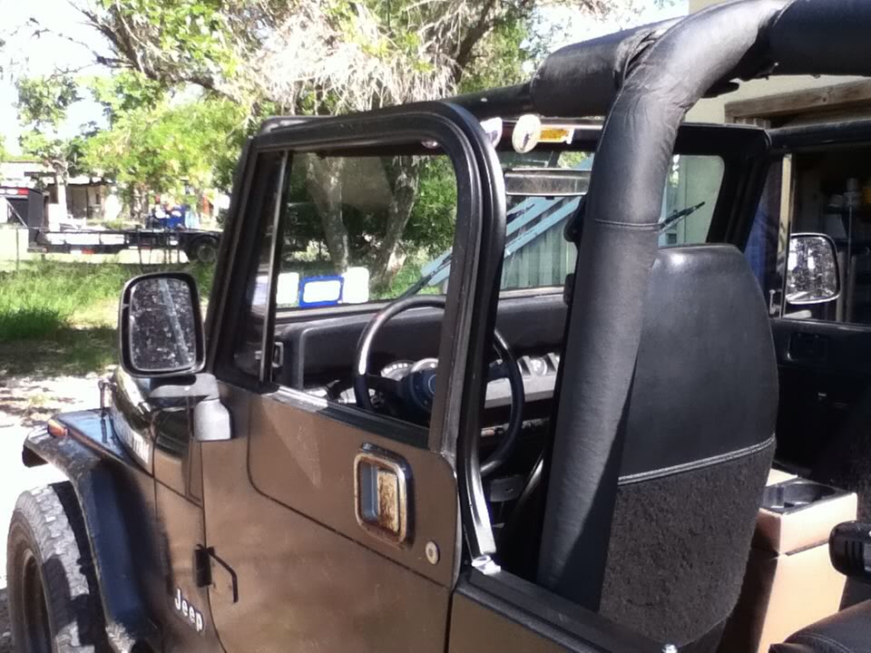

after that, you are supposed to put on the tub rails and door surrounds. the ones they make are pretty darn good if you don;t have a factory soft top and there for don;t have your own.

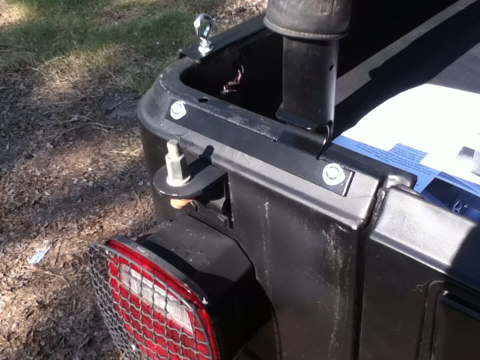

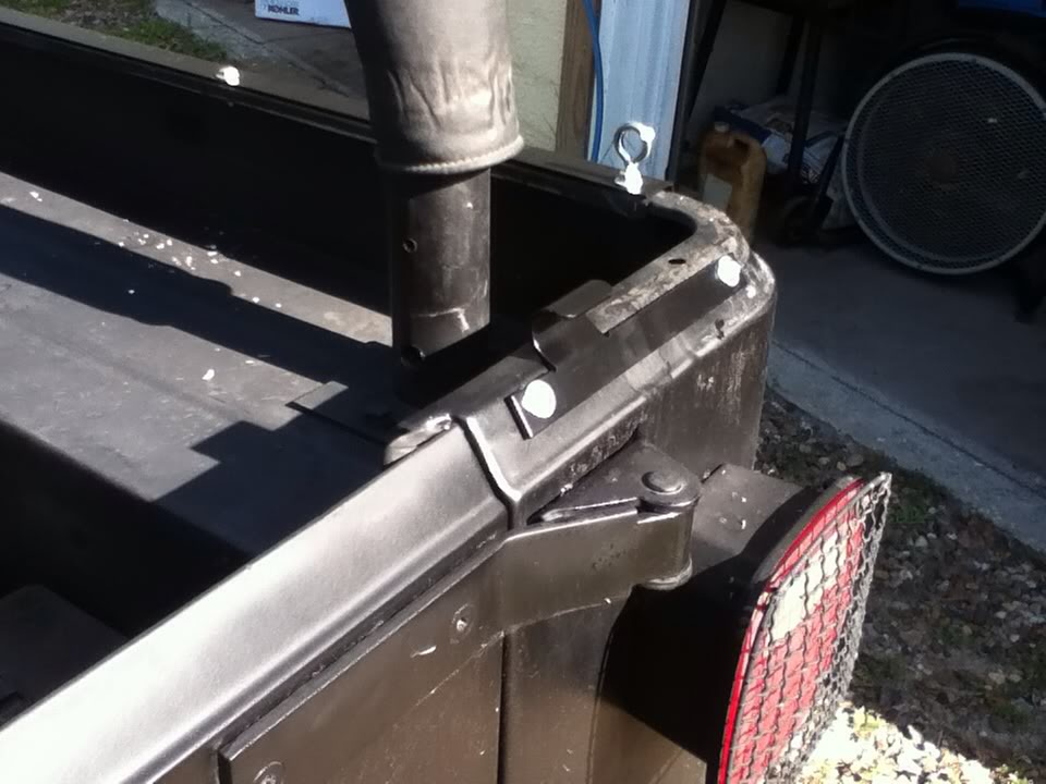

you put hte eye bolt on the back

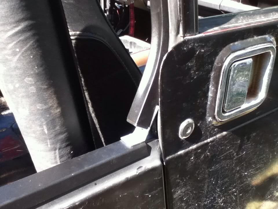

then you put some brackets on the surround (that i failed to take pics of) and use the leading bolt from the tub rail to hold the surround down.

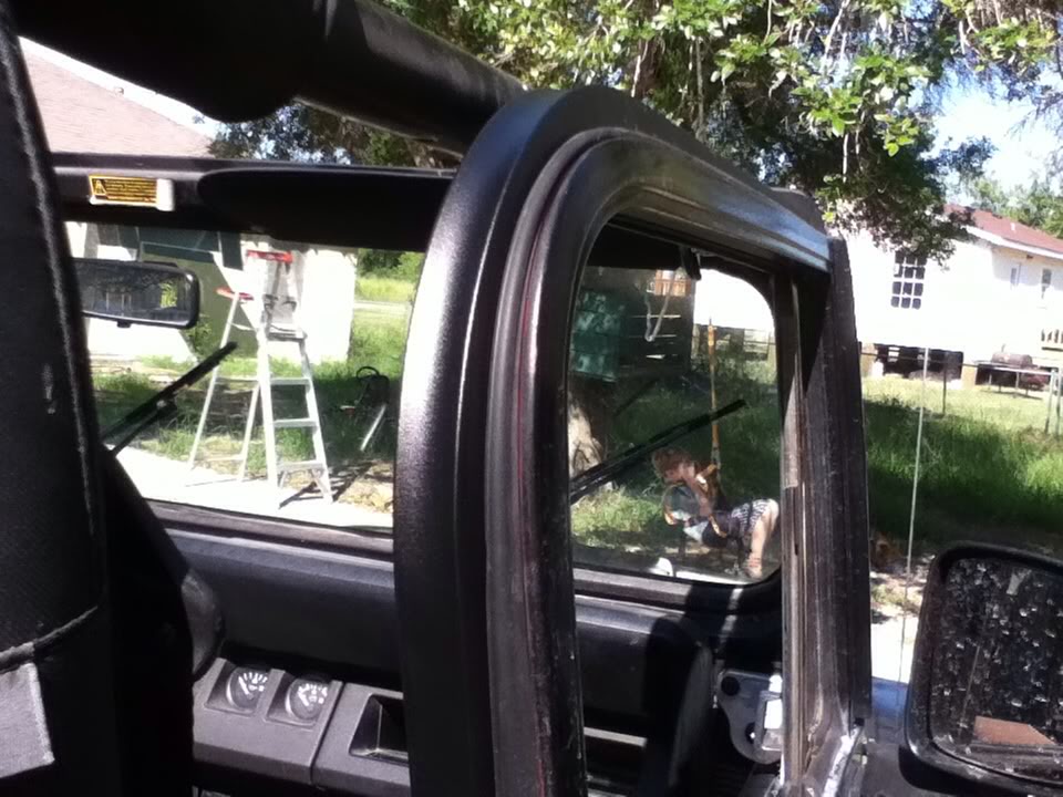

adjust the surrounds so they are nice and solidly seated against the door
and then you will look like this

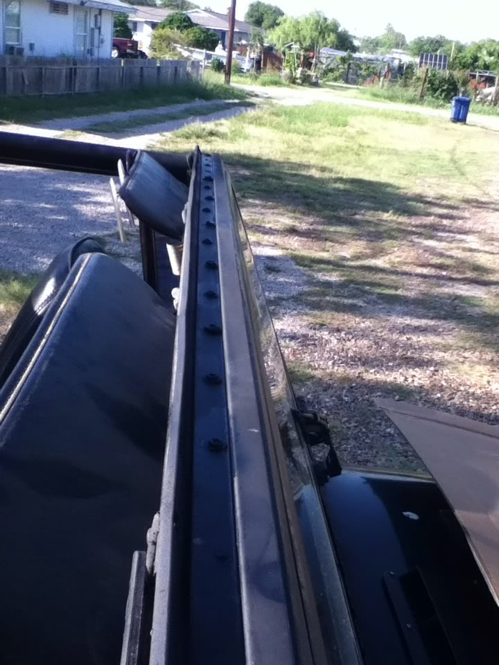

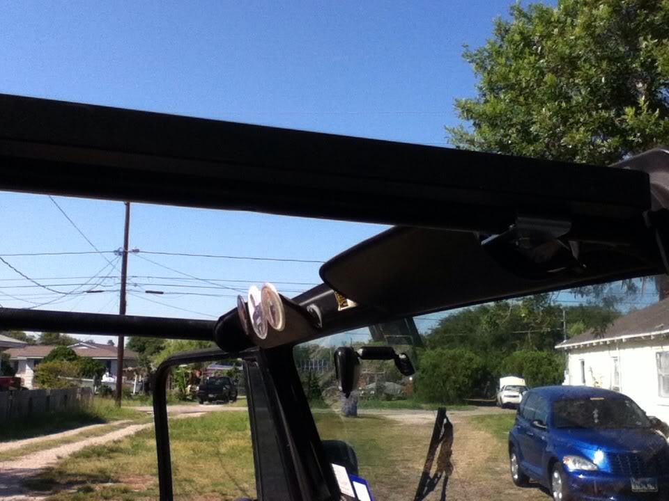

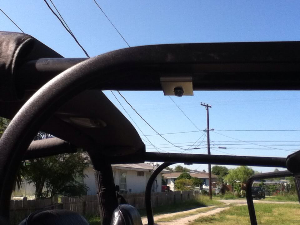

next, you put the windshield header channel on. just like anytime you put it on but they send you a smittybuilt two piece unit with the top, i prefer the old one piece unit so i reused mine. since i had removed it and installed it so many times though, i had to add some more screws. as you can tell, i am planning on not removing this top for a long while . oh ya, smittybuilt uses some really cheaply made screws. three of them snapped while i was screwing them in to the windshield.

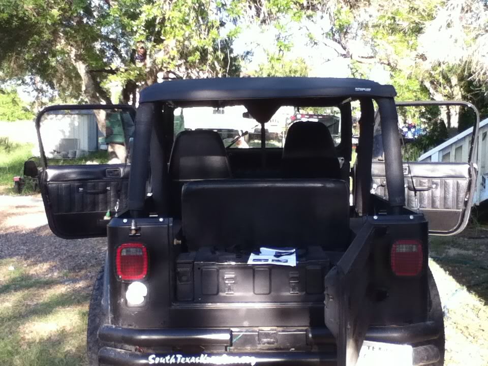

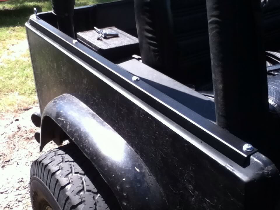

after that, you put the rear channels on the back part of the tub. the channels that hold the rear window down

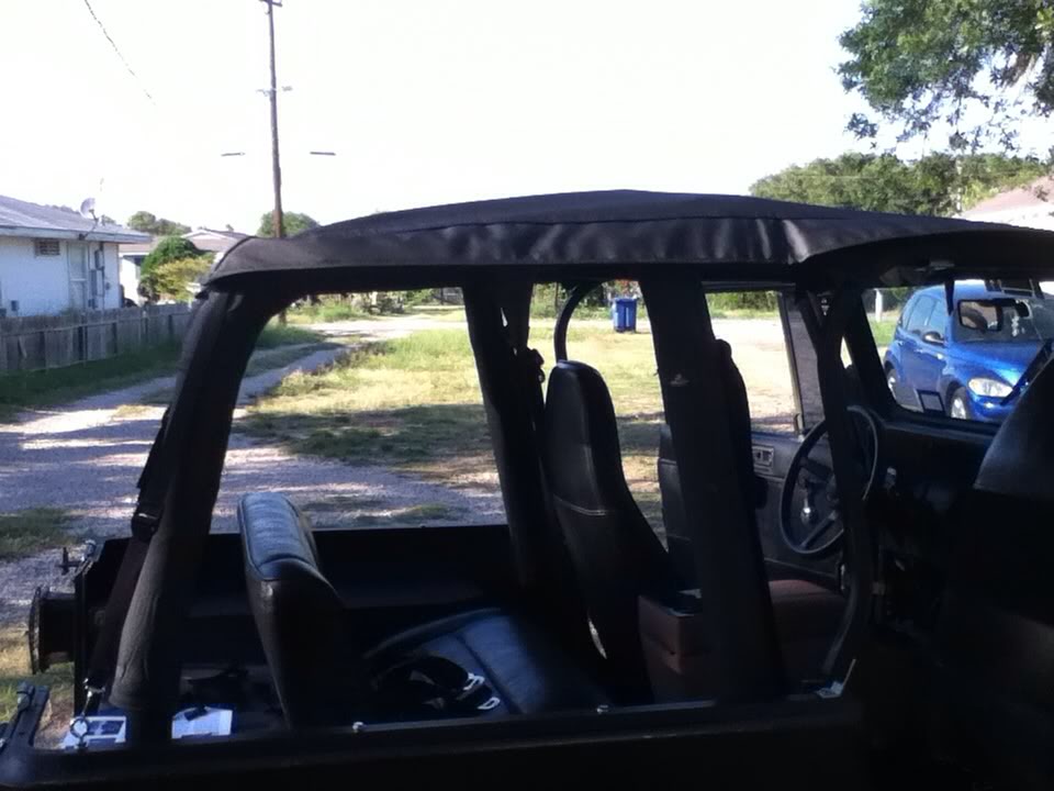

then you lay the top on

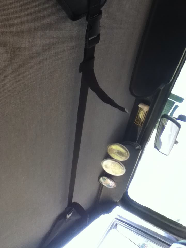

it has some cool side straps and hte one from rear to front

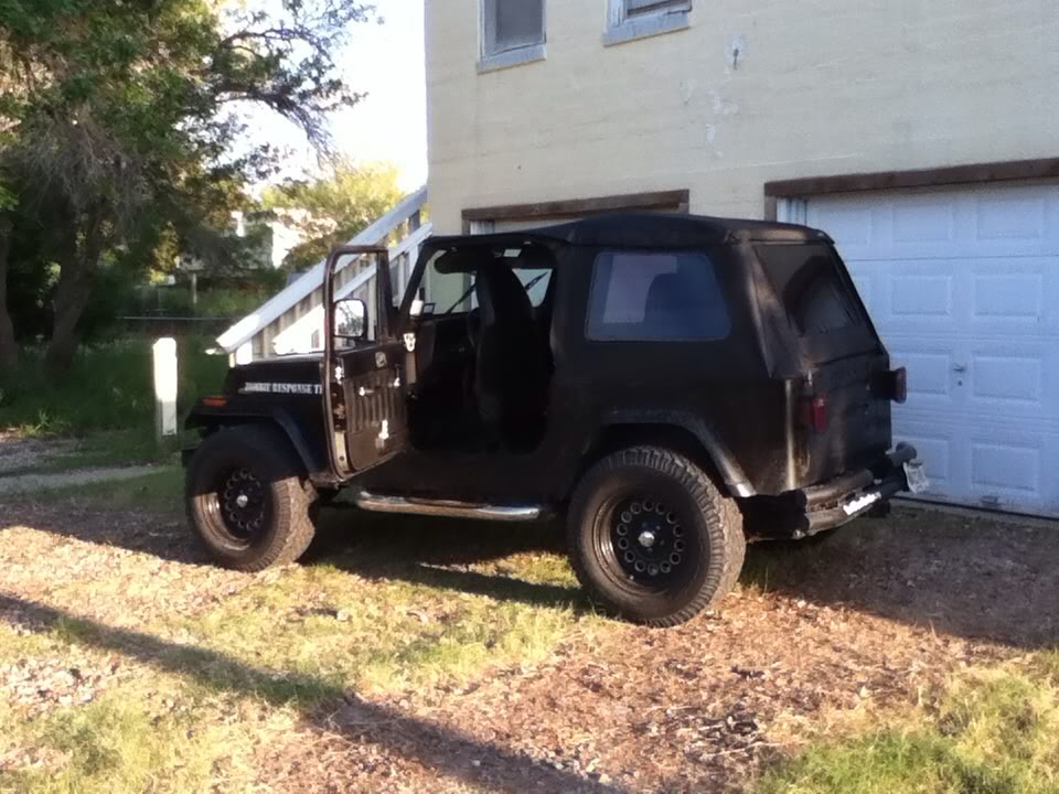

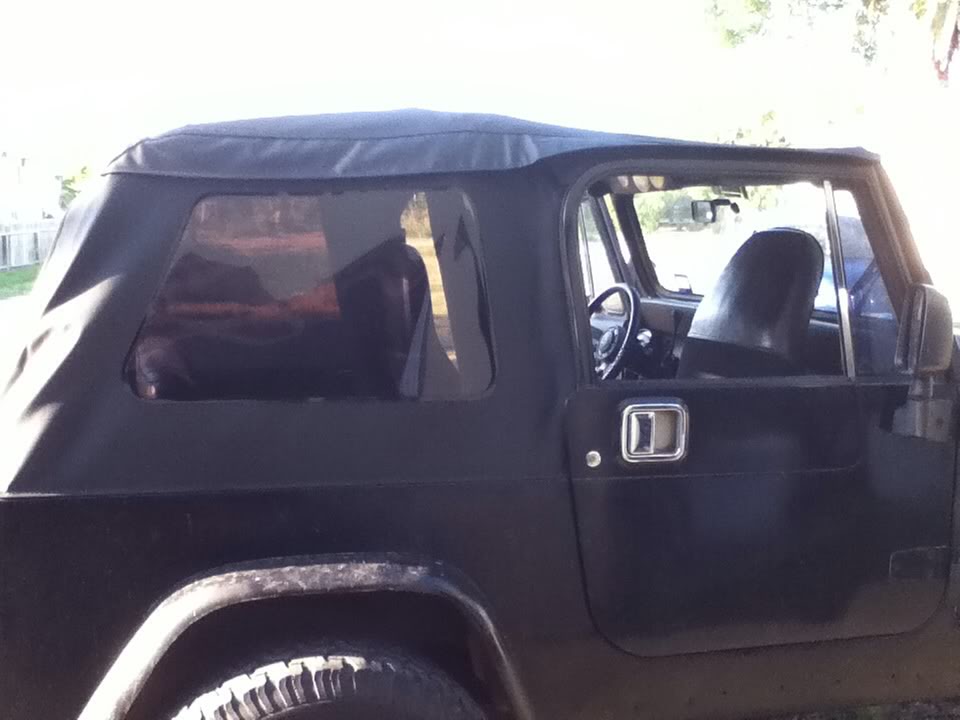

after that, you put the windows on, just like the factory top, zip in and zip the rear window in and clip everything down on the bottom

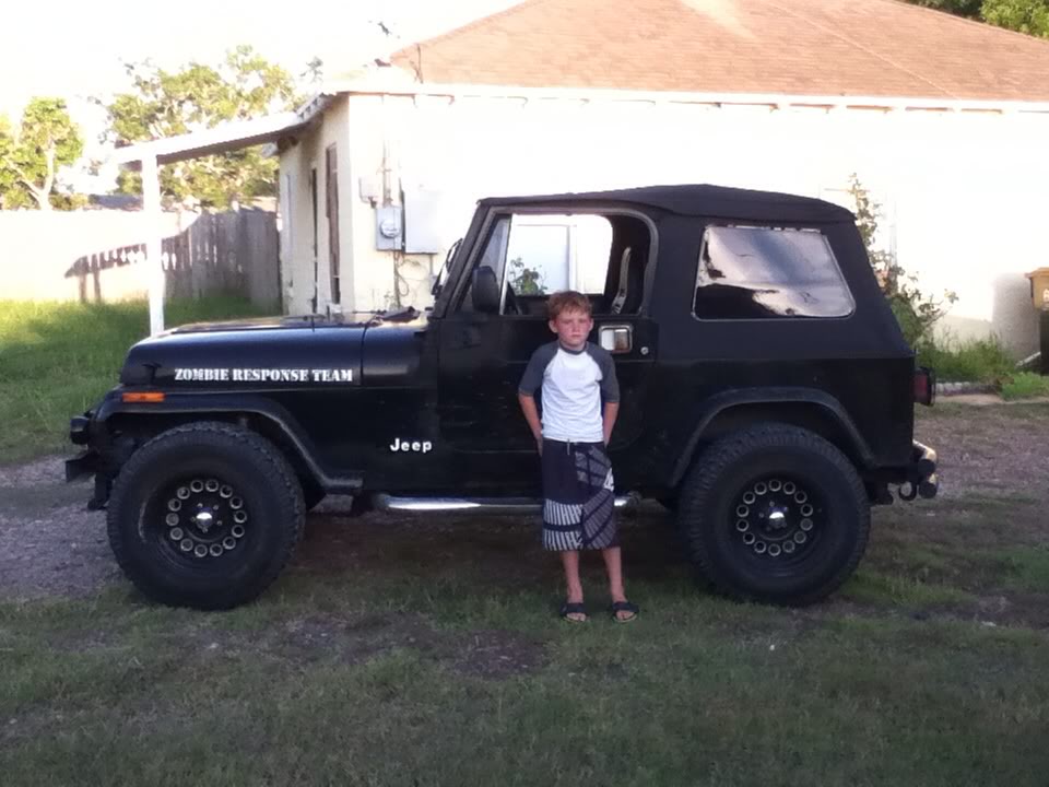

having never owned a soft to vehicle, it went well. two hours or so to put it on and that includes the spots you have to drill for the 3/8s bolts that hold the channels and brackets in place. there is also a little storage place above the driver's head where the windows go when you have them off. its pretty cool
the kids like it too
