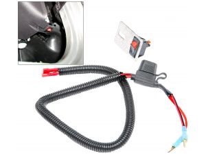

1. You can use this easily mounted switch to turn off the lights whenever you take the doors off. It plugs into the fuse box behind the glove box and the switch mounts under the glove box.

You can just remove the fuse whenever you take the doors off but the switch is easier and replaces that fuse.
