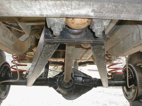

Ummmm, wow!! They are very common setups. Here's some good writeups on them. For more, go to pirate4x4.com and search "grader ball", "one link", or anything like that.
http://www.pirate4x4.com/forum/showthread.php?t=235977&highlight=grader+ball

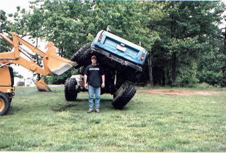

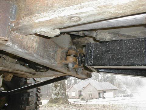

Here's a pic of a grader ball in use...on a 1 linked vehicle:
And ya, you can get a little flex out of a setup like that :wink:
intersting, i hadnt seen that before... ive seen single leefs mounted transaxle, but not that
Looks like a great setup for a trailer rig. I see it utilizes a trackbar to prevent lateral movement of the axle, but it appears to allow the axle to pivot front to back (one side to the front when the other side moves toward the rear). That explains the awesome flex, but it could get ugly on the road.
He's incorporated a pivoting mount into a modified ladder bar suspension. It's still a "two link" ladder bar, the frame mount just pivots. Ladder bars are my preference on a hot street car. Fairly adjustable, simple, solid. They can be used with coils or leafs if you use housing floaters on the spring perches. The cost is low and the fabrication is simple.
That's a smart setup for low-buck flexy wheeling, as long as it doesn't go crazy when the go pedal is pushed while it's articulated.

But, vehicles with that setup are still very drivable on the road. I never thought they would be, until I helped a friend out with a 1 link setup (and yes it is considered a "1 link" and is quite different than a 2 link). It handles very nicely on the road, and can still handle freeway speeds, fast turns, and all that other neccessary stuff.
