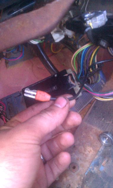

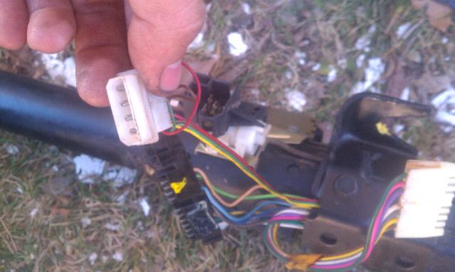

Both are auto.. the only difference in the two is one connection.. I traced my switch up because mine is pretty open and it went to were the blinked and cruise control are... ill take a pic of the two
The one with the white connection is my original one... the black one looks like maybe its for a horn but it comes out in the same place mine does....

Best to look at a wiring diagram for that jeep to see what you're dealing with. Ref the white plug, are there any tracers on the 4 wires or are they solid color?
