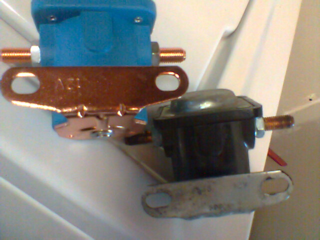

WIth the "I" terminal disconnected on the starter solenoid I wonder if this may also be the cause. I initally diconnected it on account of the starter running on and on (likely due to my gorilla arms overtorqing the battery connections to it).Original engine compartment 2.JPG
No start yet but here's a little background....
About 6 months ago a no start (at starter) problem arose. Using the DARS chart I detirmined that the solenoid was at fault. I replaced with a Streak solenoid that I mounted up and with the "I" terminal attached. Fisrt startup and the starter refused to disengage even after key off. I disconnected the battery and checked the connections. I found that by removing the "I" terminal the starter would disengage after startup as normal. I later learned from this forum that when I overtightened the battery connections to the solenoid I must've internally spun the contacts to the point they made contact.

By the DARS chart Coil Test I'm supposed to replace the coil at this point. Noting the starter solenoid, I recently had 'BB' in a trusted shop for a leaky power steering pump and subsequently noticed the "I" terminal was in fact reconnected
I think I'll still start with the solenoid, IF I can find another Blue Streak in this consumer desert.
I like SMP Blue Streak as they have that nice copper foot making for better continuity and generally much better construction than many others.

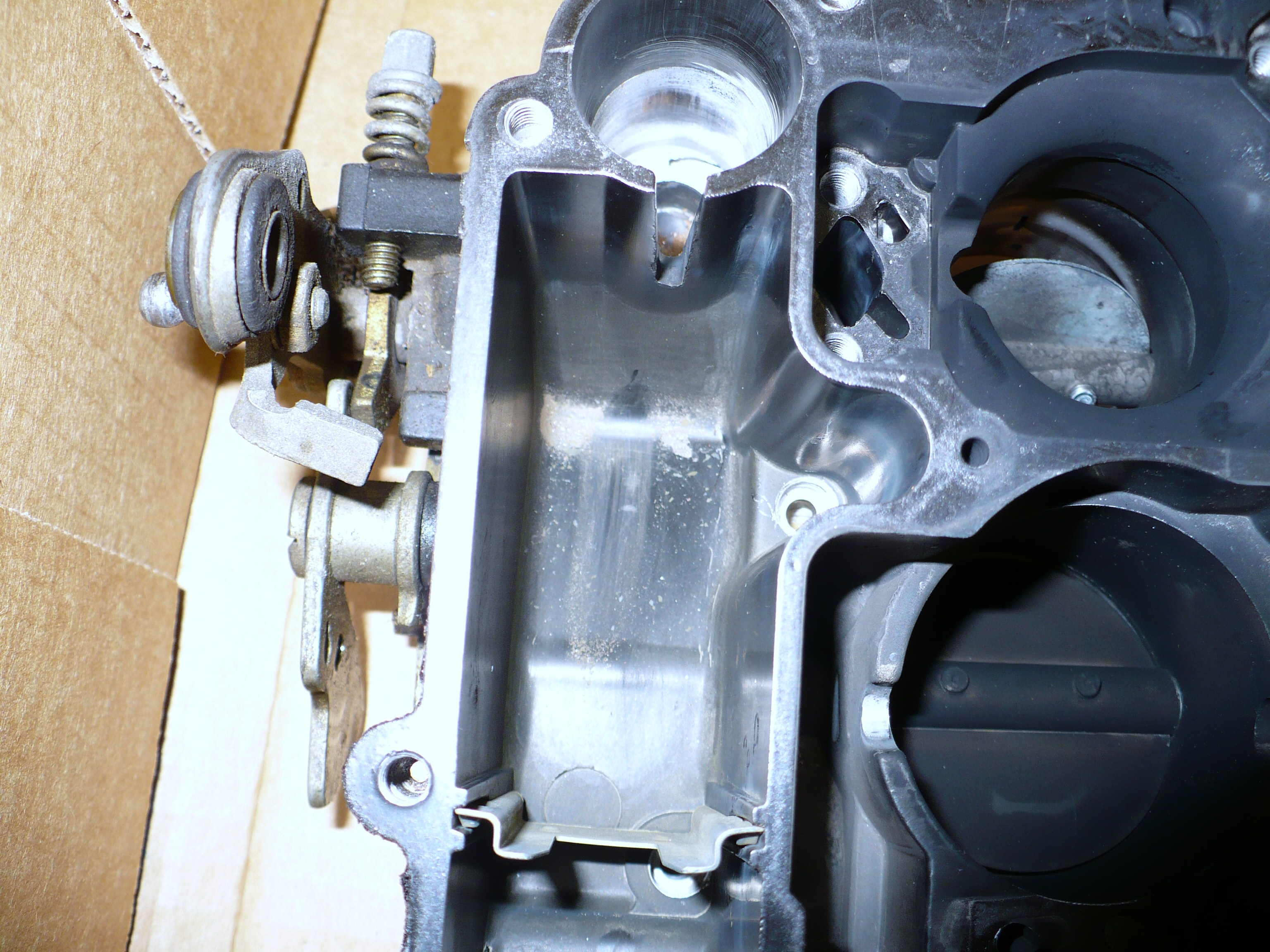

Well I got into the AFB last night and was surprised how loose most of the screws were, all of the air horn to throttle body came loose with very minimal effort. After seperating the two I found two of the four Main Metering Jets were MIA !
Also I found some fine debris in the bottom of the float bowl (accelerator pump side)
With the help of my wife's sharp eyesight we detirmined that the existing primary jets are 395's indicating .095 which on the Carter scale is about 2/3 of the way up from smallest size (.054 - .110).

Well it sounds like you got hot spark . Cheers. Whatever the history of any previous disassembly of the carburetor is , is past tense . The missing parts obviously will be acquired and reassembled. That is the answer to the overly rich condition . Looks like you've got it nailed and at least you'll resolve any issues with the carburetor as you've been wanting to do since you've suspected issues with it. I believe after the rebuild and tuning in the idle mixture you'll be able to determine better if metering rod swap will be necessary since the engine rebuild. That could open a whole new tuning session as you'll have the ability to swap venturi's if need be. The current CFM output is probably able to cover your torque/hp needs with the current displacement but it's nice to know you have that option. I see some tuning in your future !
BTW , the pictures show clearly that the misses were mini backfires due to the over rich condition as the Venturi bores and throttle blades are carbon caked. It seems you've gotten to the bottom of this high speed miss that has plagued you so long . Looking forward to good news soonest as Black Betty hits the road again soon !

I've cleaned up the Throttle Body and Air Horn using Carb Dip and Carb Cleaner (spray can) now it's on to the small parts, much of it is coated with a very fine soot that I can only assume is due to the starting fluid since the plugs looked fine a couple of weeks ago.
