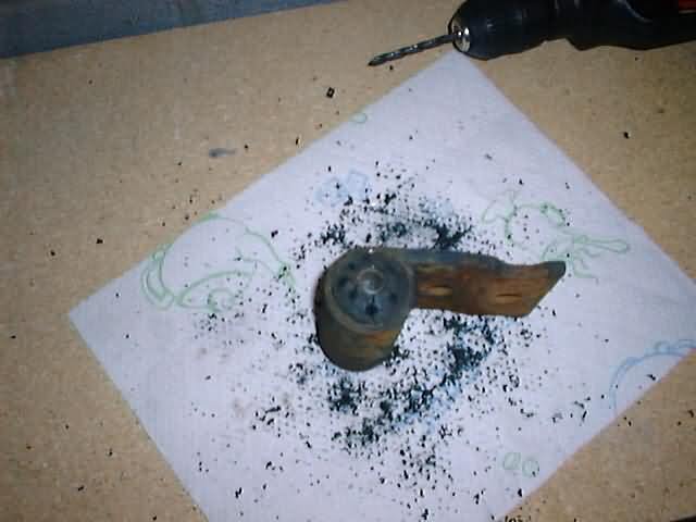

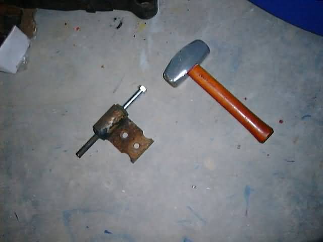

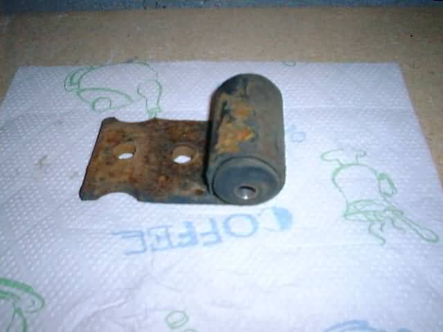

Now you must replace the bushings. Bushings are the spacers that sit between the spring and the shackle. You have two types of bushings to choose from - rubber or polyurethane. Rubber is stock, and seems to absorb more shock, but polyurethane will not deteriorate, so most people use poly. I bought my new bushings from JCWhitney. To get the bushings out, you'll want to drill holes in the old ones, then knock them out with a hammer, as the pictures below illustrate:​

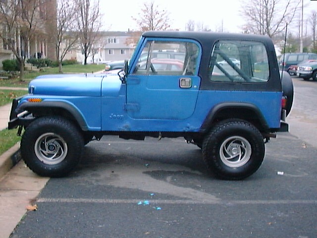

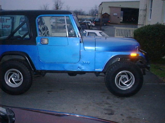

wait.....is that really a before and after example? It doesnt look any higher. Thats with new shocks and add-a-leaf springs?!? Wow...I thought the change would seem more drastic. How much do you notice when youre driving? Im trying to decide on how much I want to lift my cj....
I think so it's 2.5 in lift so it's not going to be drastic. Look at the space from the tire to the fender.
