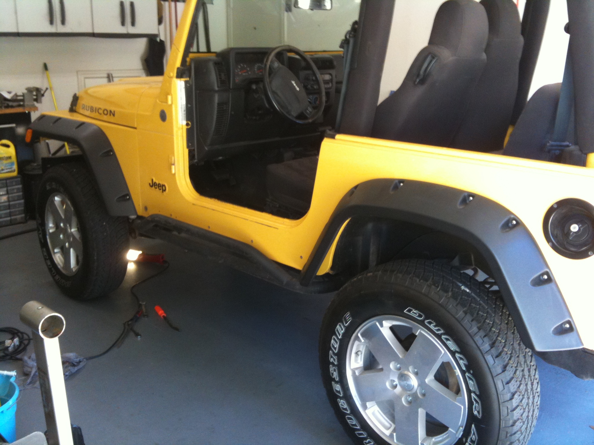

Here is a pic:

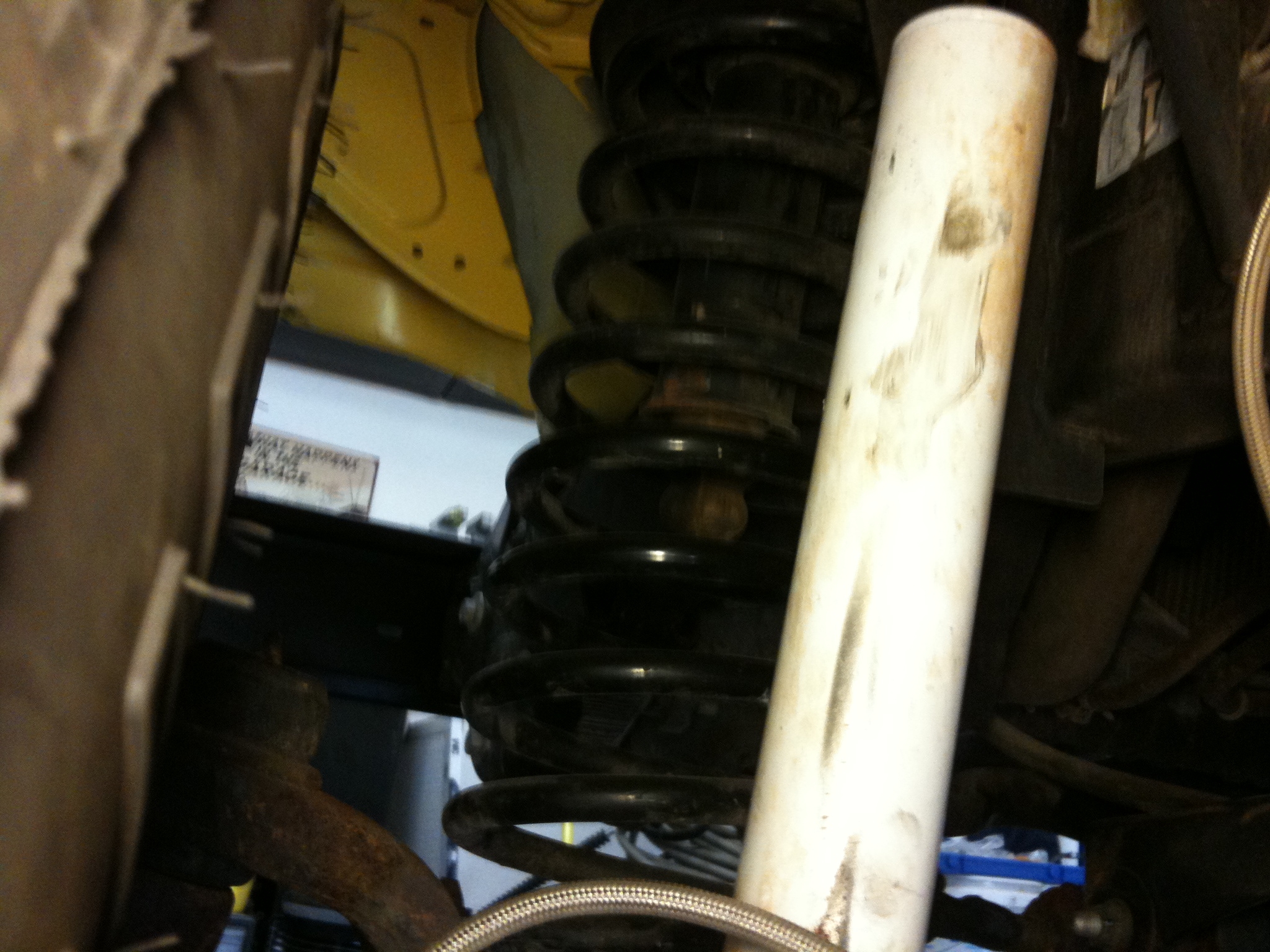

here is a dark pic of the front spring:
There are no spacer blocks at the top of the springs, but the wheels do have spacers.

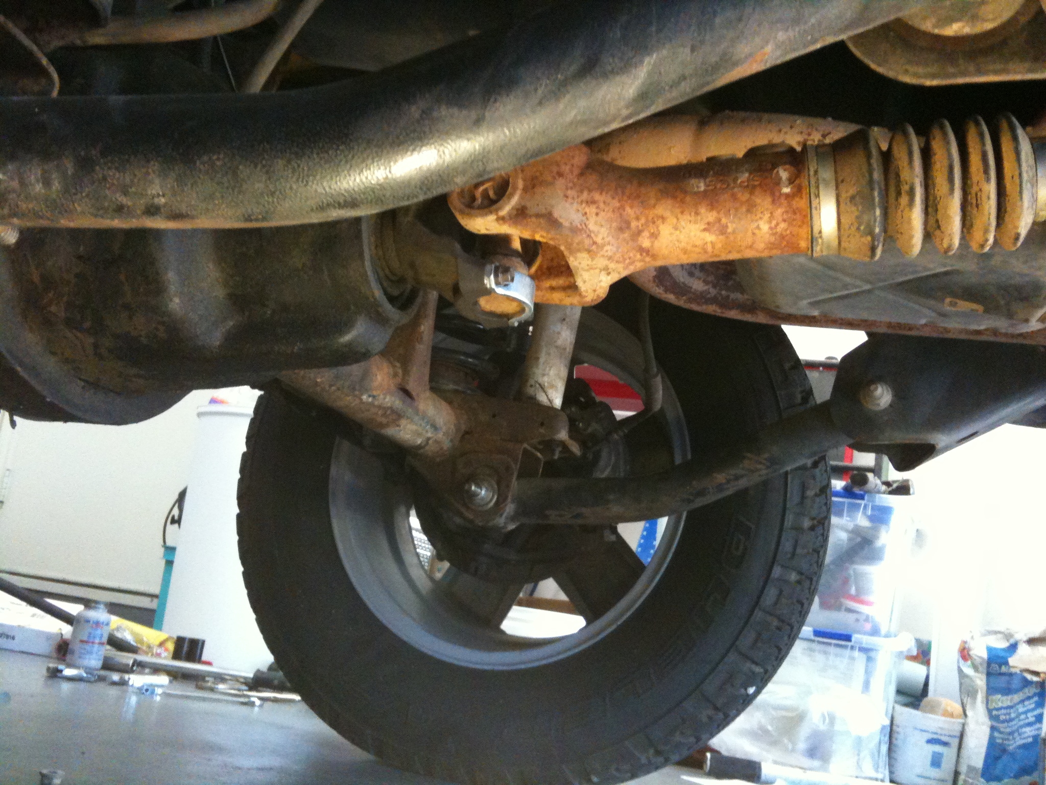

Wow I just discovered the front stabilizer bar is completely missing :x
The tracking bar seems to be intact, although the bolt on the bushing end where it connects to the axle was about to fall out when I got it. I bet the bushing is wallowed out
Those are definitely after market lower control arms, they likely wouldn't be there unless it was lifted. The wheels look stock to me.
Really? I would have thought aftermarket control arms would have included provisions for caster adjustment. Guess not. If it has been lifted without provisions for adjusting caster, it is probably out of spec.

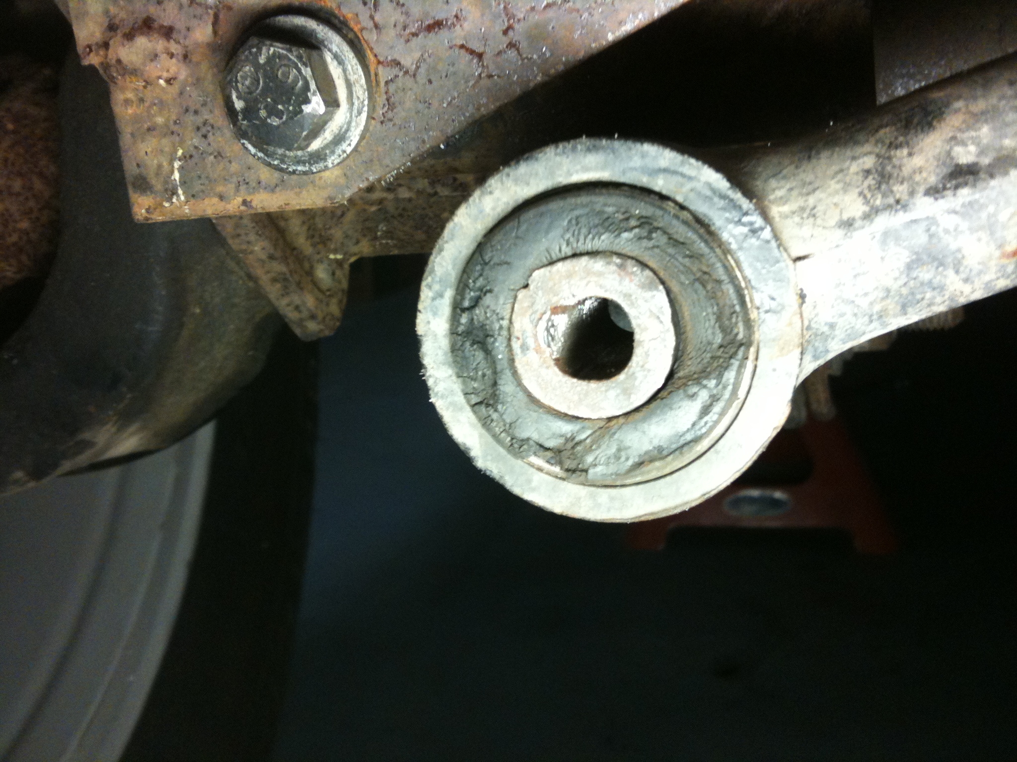

My track bar bushing looks like it has seen better days:
My stabilizer shock does not appear to be blown, but the bushings are in poor shape.
The upper control arm bushings seem soft and mushy too...
Those are definitely not stock wheels. If that is really a Rubi model, the wheels look completely different (and obviously those aren't the stock tires either.
Thanks, that is what I figured.
It is a rubi according to the VIN, but some A-hole stripped all of the rubi goodies off of it.
Many lifts come with new longer lower control arms that aren't adjustable, but are the correct length for the lift they are sold with. My guess is that your Jeep is lifted. Do the shocks have any company's name on them?

How tall are your springs when it's sitting in the driveway? I've got a 2.5" lift and my front coils are 14" tall with the vehicle weight on them.
