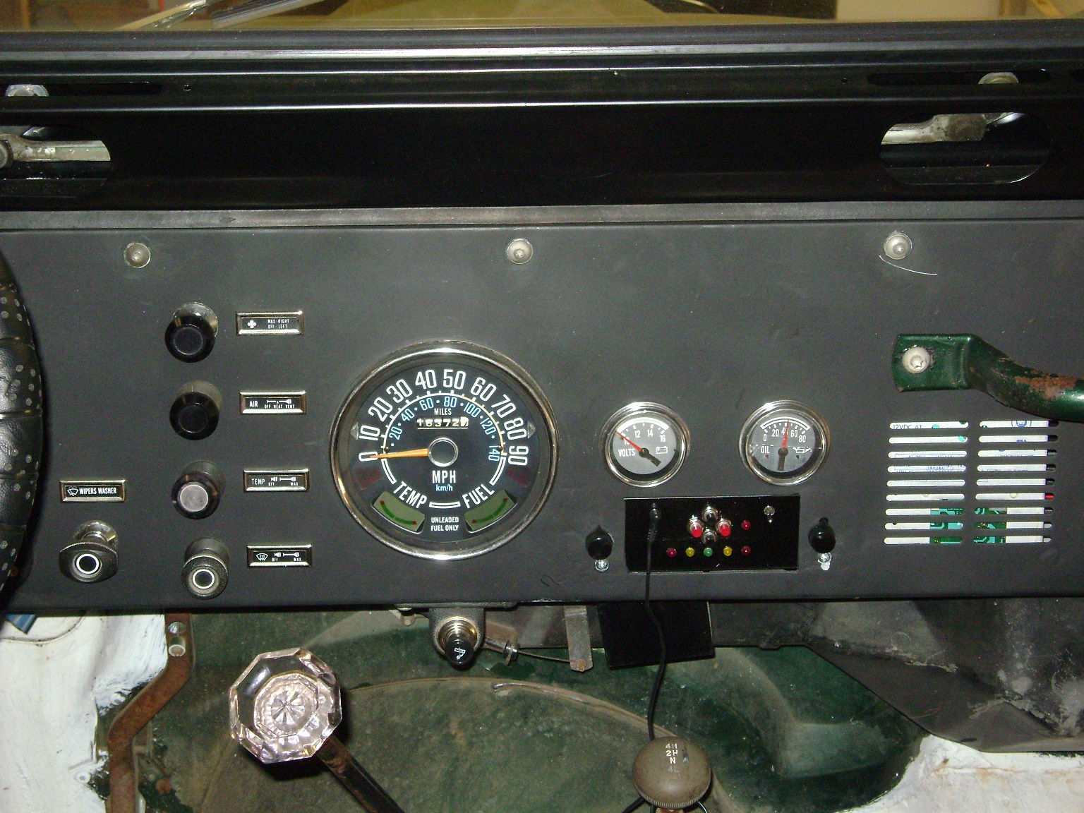

Hi,
I opted on the cheap, but good deal.
My Jeep had no sound when I got it. With no locks, and a rag top I wasn't willing to tempt people too much.
I installed a 100 watt amp behind the dash, on top of my heater box.
Fed the remote amp power to my ignition switch, so the amp powers off when you turn the key off.
Installed a pair of carpeted 6X9 boxes, on top of the rear wheel covers. With decent 6X9 speakers.
I run my portable mp3 player into it for my music.
This is just 1 of many ways to jam, at least now I don't have to sing anymore....
Got the amp from a pawn shop $40.00 - Speaker boxes $ 30.00 - Speakers $ 70.00 - MP3 cable $12.00
