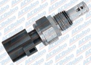

is it this thing?
...part no. 89053502

Im sorry to inform you that what you have on the pic is NOT an Ambient temp. sensor but instead looks like a coolant temp. sensor. the Part# for the Ambient Temp. Sensor is,56027872.
Your battery ambient temp sensor monitors the battery temp (well, the bottom of the battery) and allows the ECM to tailor the charge depending on the temp. Batteries need a little heavier a charge rate when they are cold and less when hot. To remove it just remove your battery and you'll see it in the center of the tray. Unplup the wiring harness connector under the tray and remove the sensor. I don't remember, but, I think you push-and-turn to remove the sensor (anyone else have their's out???). Your problem could be the connector or wiring to the sensor and not the actual sensor itself, though. Any acid leakage convieniently follows the temp sensor wires down to the connector. Best of luck - John
O.k. disregard my prior post. i have been searching for this ambient temp. sensor on the diagram but with no positive outcome. that part# is the intake air sensor, not the ambient temp. sensor.
