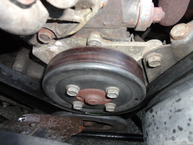

'96 XJ 4.0 here ... So doing about 10 mph, right before turning into the driveway I hear some kind of rattle/clunking sound for about 2-3 seconds coming from the engine and just that second I lose power steering. I crank it on into the drive, pull around back and get out to see I've been putting out coolant all the way back to where I lost the steering out in the street. And right there as I'm parked the engine temp is normal but there's all kinds of coolant pouring out the front of the engine. It continues to rain down for the next 3-4 minutes while I scamper around getting my face burned in the stuff trying to see where it's coming from. After getting a couple angles on it it seemed to be coming out from behind the top big pulley in the center of the engine.
Isn't that the water pump pulley? So what type of equipment failure do you have when there's a rattle sound followed by coolant pouring out the front of your engine around the water pump? Almost sounds like something failed mechanically in the pump which led to the leak. I'm guessing replacing whatever it is shouldn't be too difficult.
But then why did I lose power steering? Could coolant on the belt have caused that?
So now I've confirmed I def need to replace the water pump. I've got Oreilly's, zone, advance and quest close to me. Any particular brand pump I should go for? I'd like to at least get OE.
Ideally a new as opposed to a remanufactured pump, do not forget a gasket.
You lost lots of coolant SO perfect time to replace thermostat (use correct temp) look at those hoses. Maybe even a flush.

And yes the PS will slip with coolant on it - how does the belt look - perfect time for a change.

Check your belt. Tensioner and idler pulley. A wet belt can slip and coolant is slippery.
Also check your clutch on the clutch fan.
